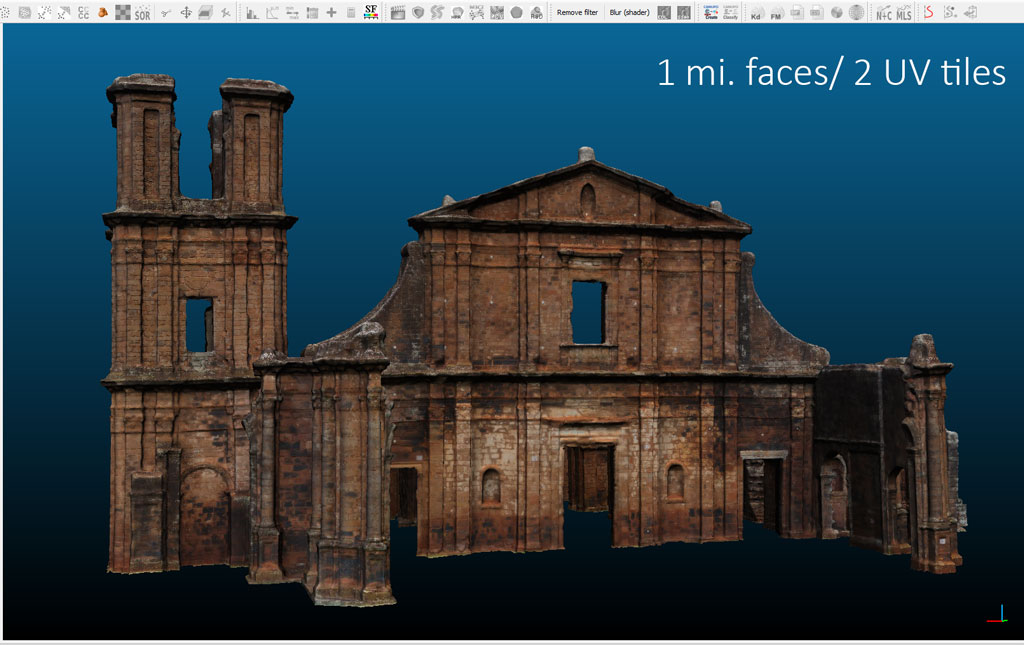

This is the result of the first model, after manipulating the viewport:

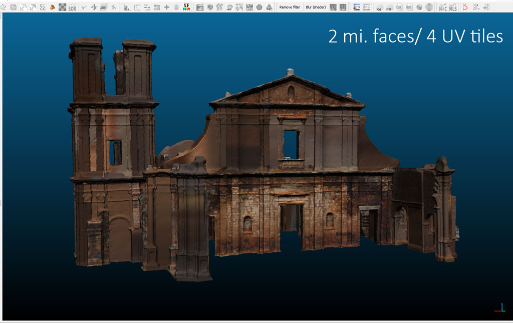

And this is what I get with the other two as soon as I do anything to the viewport:
