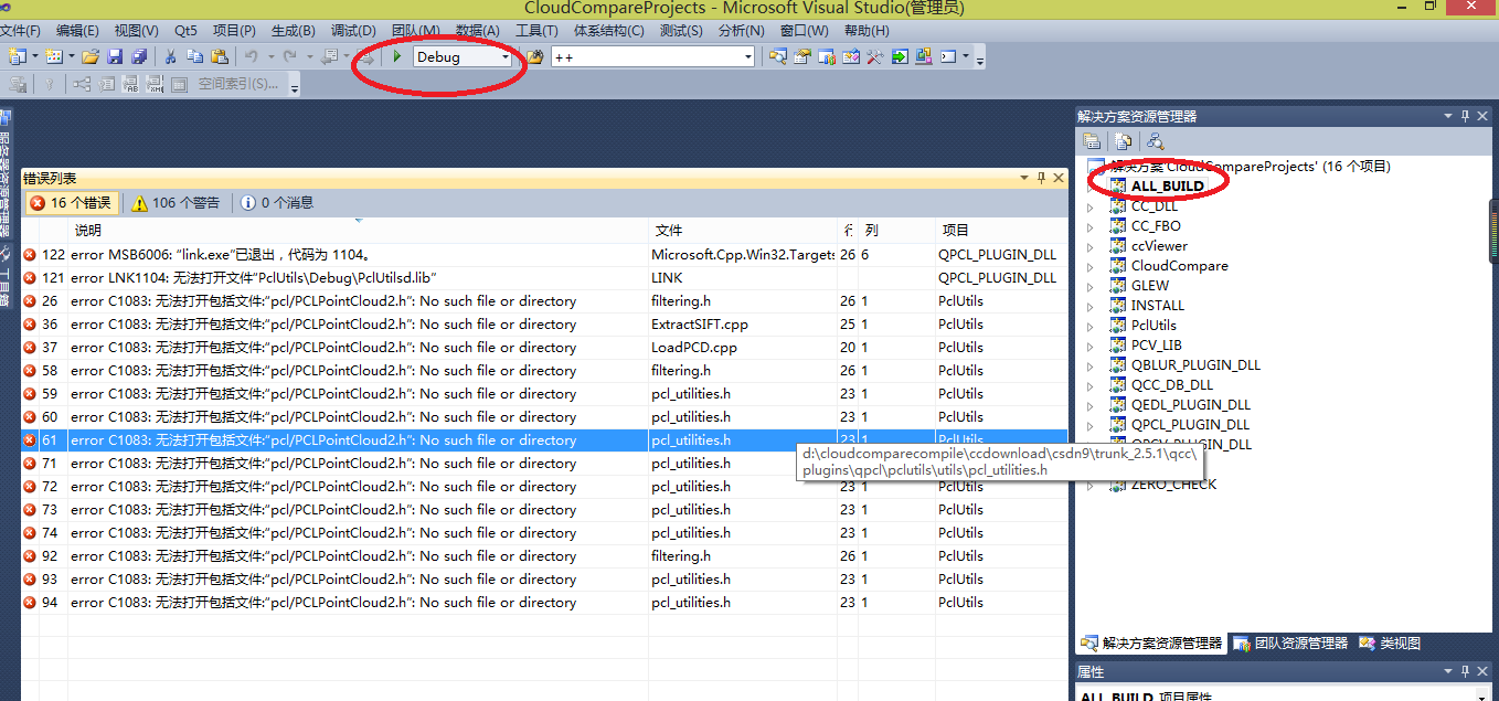

when compiled trunck2.5.1 version,I tried to add plugin.
there are some warnings,Eventually MSVC2010 has the following error in the console.How could I debug that?

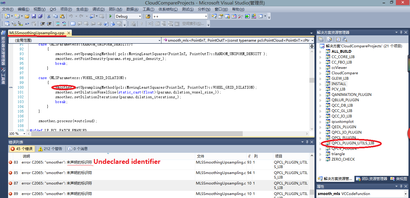

I try to add qanimation_plugin,qblur_blugin,qpcv_plugin,qedl_plugin, These are all successful.but when add qpcl_plugin,I can see in the console the following message
How should I do?
How should I do?

I bet the class of the 'smoother' object is not recognized (you must have an error about an undeclared specifier, or something equivalent). And it probably means that you are not using the right version of PCL.

Thank you so much for your help,When I use PCL1.7.1 instead PCL1.6, I succeeded.
