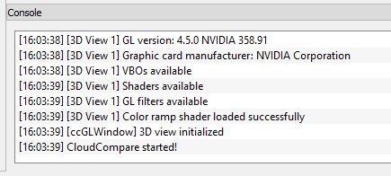

With updating to 2.7 we removed any previous versions. Opening CC 2.7 being logged directly onto the computer we have the following OpenGL and graphic card manufacturer:

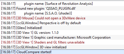

We found an old installation file for 2.6.2 that we were able to reinstall on our computer. When opening via remote desktop the console shows:
Re: Error opening 2.7 over remote desktop
Ok, CloudCompare 2.7 requires OpenGL version 2.1 at least.
I wonder if remote desktop can 'emulate' OpenGL 2.1 instead of 1.1?
Meanwhile I'll try to prevent CC from crashing when running with lower version (and issue a proper error message instead ;).
