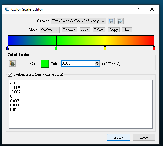

Thank you Daniel. But I was wondering why CC always clash when I try to modifying the value of the selected sliders?

daniel wrote: Sun Aug 22, 2021 3:22 pmclash? Or crash?
crash, and then I have to restart the program again
And how we can change the color scale in absolute ? I mean absolute color difference(red, then yellow, then black, etc) instead of color gradient

So the crash is definitely not normal! Which version are you using? Do you have a reproducible way to make CC crash?
And then, the gradient is the default mode. You have to trick CC by defining two steps very close to each other (like 1 and 1.00001) at each color changing point to visually achieve what you are looking for.

daniel wrote: Tue Aug 24, 2021 7:28 pm So the crash is definitely not normal! Which version are you using? Do you have a reproducible way to make CC crash?
Thanks for your reply, Daniel!
I am using CC V2.12 alpha running at Windows 64-bit.
I encounter the same issue every-time when I edit the absolute value directly, it will crash.
Image 2.png (12.5 KiB) Viewed 15109 times
I am sure my workstation is capable to run the CC and the point cloud size is within 10GB.
Also, I am wondering if CC can generate the color scale bar like this interval:
(C2M<-0.01),(C2M<-0.005),(C2M=-0.005),(C2M=0),(C2M>0.005),(C2M=0.005),(C2M>0.01)
Thanks again for your help!

Ok, I haven't reproduced the crash, but I have indeed found a problem when manually changing the value/position of a color ramp step... I'll look at that ASAP.
Re: Scaling the Color Scale
I have found the bug (and hopefully fixed it, you can try with the new 2.12.alpha version online).
And to create the color ramp you want (with the trick I suggest), with fixed color, you have to start with an absolute color scale and then:
1) reduce it to 2 steps
2) make sure the steps are above the maximum value you target (e.g. 1.0 and 2.0). And then:
3) select the first step, set the right color (the farthest), and edit its value to the minimum value (-0.01) then click somewhere else
4) click anywhere between the 2 steps, and edit the newly created step
5) set the color to the next segment color, and edit its value to something very close (-0.099) then click somewhere else
6) click anywhere between the 2 last steps, and edit the newly created step
7) set the same color and edit its value to the next intersection (-0.005) then click somewhere else
8) repeat from step 4
