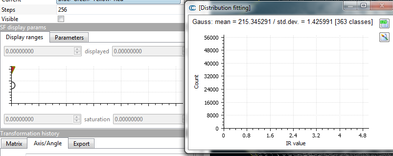

I add a scalar field and set scalar values by a pushbutton.
The values are changed but histogram is disable.
Re: Is it possible to change scalar field value?
If you modify a scalar field, you must call 'computeMinAndMax' once all modifications are done (it updates the min and max values that are used by many tools and widgets).
