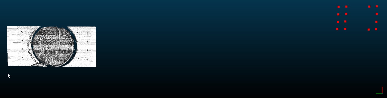

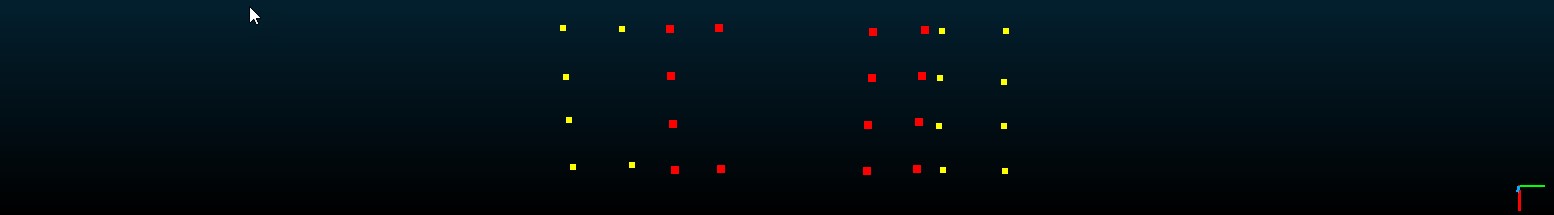

I am currently working on a university project of lidar scans for a changing sample volume over time (drying therefore decreasing in size) in a petri dish, requiring highly accurate volume measurements. The petri dish sits on a marked up wooden base board with small drill holes used as a reference grid to assist in aligning & comparing multiple scans. I have imported the coordinates for the board grid into CC as a layer (assuming a Z of 0 and the first hole as reference 0,0 as X,Y), and imported the scan data as a separate layer. Unfortunately, the scanner heavily distorted the clouds in the Y axis, and this was easily overcome by applying an approximate Y factor of 0.2 on the Scale/Multiple tool (not the correct scale as currently unknown).
The problem is that, I cannot get the points between the two sets to align and scale correctly (i.e. transform). I have used the ‘align two point clouds by picking at least 4 points’ function, with all varying options selected ie. Adjust scale, rotation x/y/z, to XY to X etc selected/attempted to no success. The clouds come to the same Z = 0, with roughly the same X scale but Y always distorts no matter the process. It is important that the same method be used consistently, as there are many scans to analyse and accuracy in measurements is imperative.

In fact I just don't see how your clouds could match. No 4x4 matrix could fix your issue. Even non-rigid registration techniques can't help you in fact (anyway you can't expect reproducible and accurate results with such methods ;).
While the left and right parts seem to have a almost correct relative scale (i.e. the left red part roughly matches the left yellow part, and same thing for the right parts), their relative distance is totally different. You would have to increase the gap between the base plate parts of up to 90 (mm ?) to make them roughly match with the scan.
How did you acquire both set of points exactly? Can you share the original data with us? (you can also send them directly to me: cloudcompare [at] danielgm.net).
