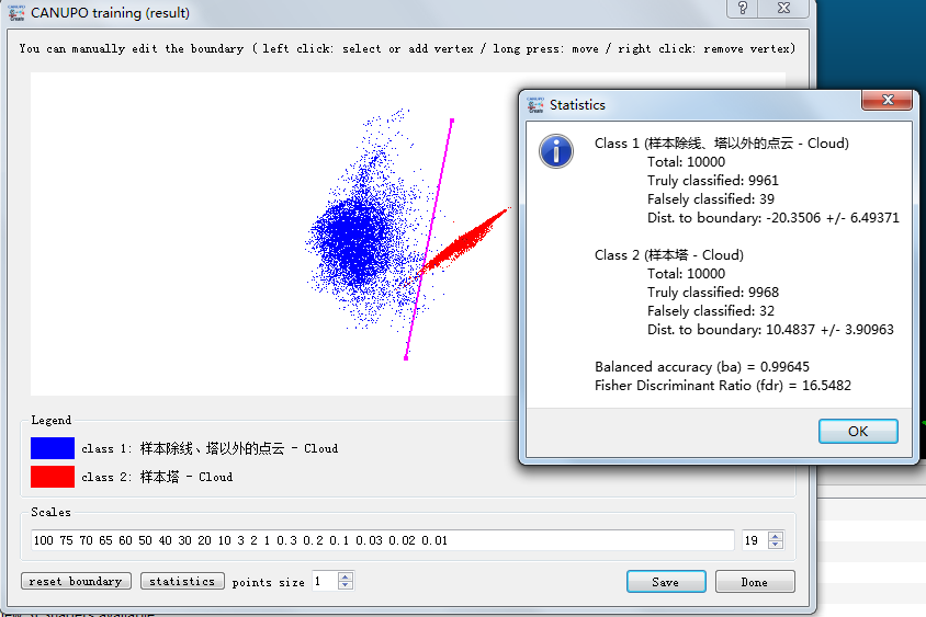

Hi Daniel, I have been focused on this forum for a long time and learned a lot of things.it’s my first time to ask some questions .I try to use the CANUPO to classify the vegetation、buildings、towers、wires、roads and so on.I have seen the PDF of manual of classifications,but I can’t understand the mean of Scales,and I don’t know how to give the values of scales.I have tried to classify many times,however, The results are all not very well.
My date is from Airborne Ladir.I really want to know how to give the value of scales which is on the dialog of Train classifier.
For example,if I want to classify the tower ,how can I use the CANUPO,and what's the value of scales.

I feel the result of classification training well from the dialog of CANUPO training and the Statistics.

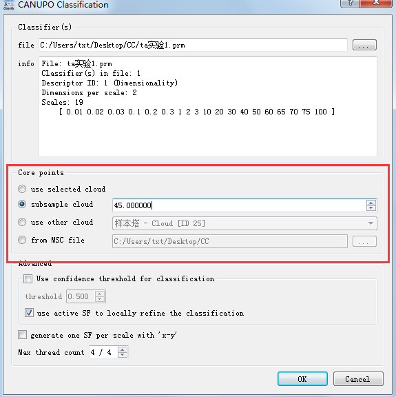

And use this .prm,what's the meaning of the Core points on the dialog of CANUPO Classification.

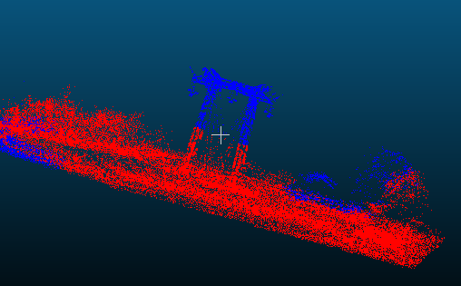

The result of classification is not good.
Re: classifier
@Bonnie: no, the '1 cm - 1m' range was only an example. It depends on your cloud units AND on the objects scale! If what I see on your screen capture is an electric pylon, then the scale is probably much bigger.
