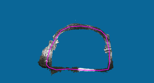

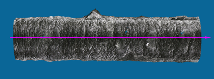

Also how would you unwrap a tunnel? would you put the polyline down the length of the tunnel or around it (See images)?

To 'unwrap' the tunnel, you would have to use the second option (draw the polyline around it).

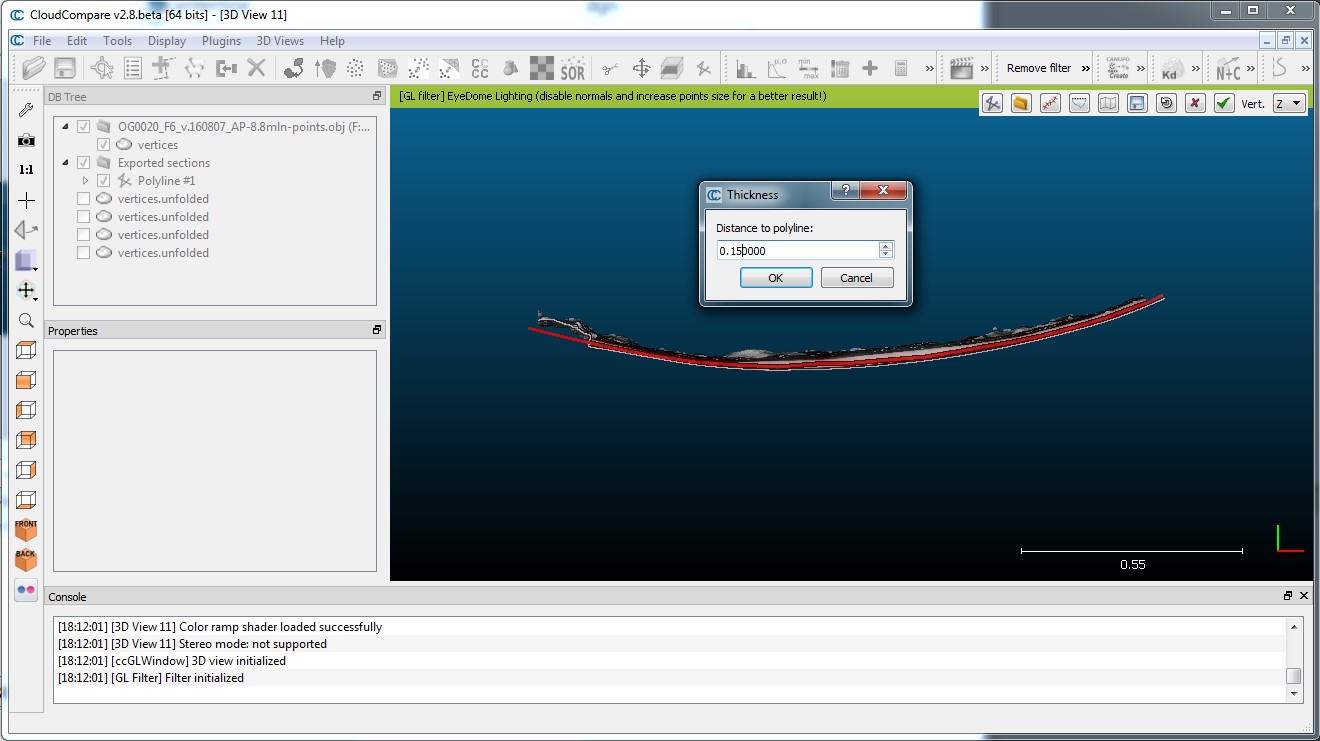

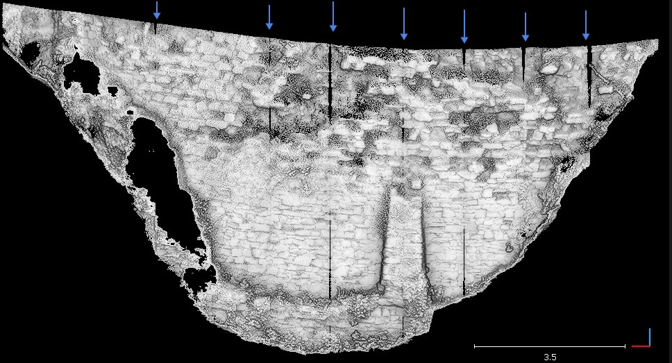

I got a gaps on resulting point clouds. Tryed to make unroll many times. Tryed to place 120 vertex on polyline to get smoother polyline. Tryed different Thickness on Distance to polyline dialog. Always I getting this gaps.
Is there a way to make unfold point cloud without a gaps on pertex position?
And daniel has same problem too on his result
Re: Texture of collapsed towers
I'll have to investigate a little bit more about this to give you a proper answer but I remember it happens when the wall is not perfectly vertical. At least on the tower example this was the explanation.
Don't hesitate to send me your data and I'll look into it (cloudcompare [at] danielgm.net).
