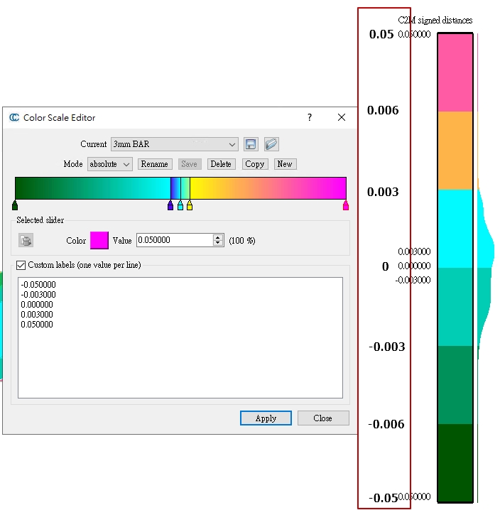

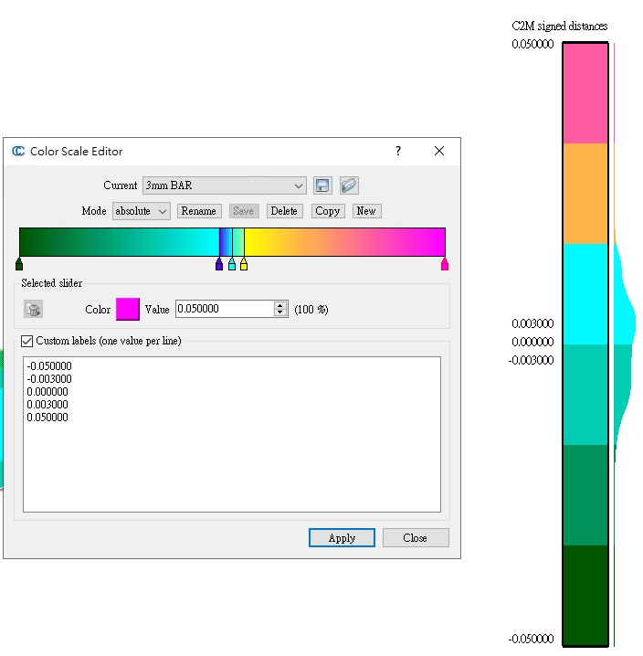

This is what I can do:
圖片 72.jpg (101.88 KiB) Viewed 9964 times
But may I set the color scale bar like this?
圖片 73.jpg (118.15 KiB) Viewed 9964 times

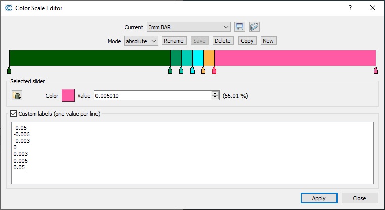

Re: Scaling the Color Scale
Here is what I was able to create:
Here is the XML file if you want to load it in CloudCompare (just save that in a file with '.xml' as extension):
<?xml version="1.0" encoding="UTF-8"?>
<CloudCompare>
    <ColorScale version="1">
        <Properties>
            <name>3mm BAR</name>
            <uuid>{bd7b4322-6026-4ec0-bbad-5ecf479d72d5}</uuid>
            <absolute>1</absolute>
            <minValue>-0.05</minValue>
            <range>0.1</range>
        </Properties>
        <Data>
            <step r="0" g="85" b="0" pos="0"/>
            <step r="0" g="85" b="0" pos="0.4399"/>
            <step r="0" g="145" b="90" pos="0.44"/>
            <step r="0" g="145" b="90" pos="0.4699"/>
            <step r="1" g="205" b="180" pos="0.47"/>
            <step r="1" g="205" b="180" pos="0.499"/>
            <step r="1" g="250" b="255" pos="0.5"/>
            <step r="1" g="250" b="255" pos="0.53"/>
            <step r="254" g="180" b="73" pos="0.5301"/>
            <step r="254" g="180" b="73" pos="0.56"/>
            <step r="255" g="91" b="164" pos="0.5601"/>
            <step r="255" g="91" b="164" pos="1"/>
            <label val="-0.05"/>
            <label val="-0.006"/>
            <label val="-0.003"/>
            <label val="0"/>
            <label val="0.003"/>
            <label val="0.006"/>
            <label val="0.05"/>
        </Data>
    </ColorScale>
</CloudCompare>

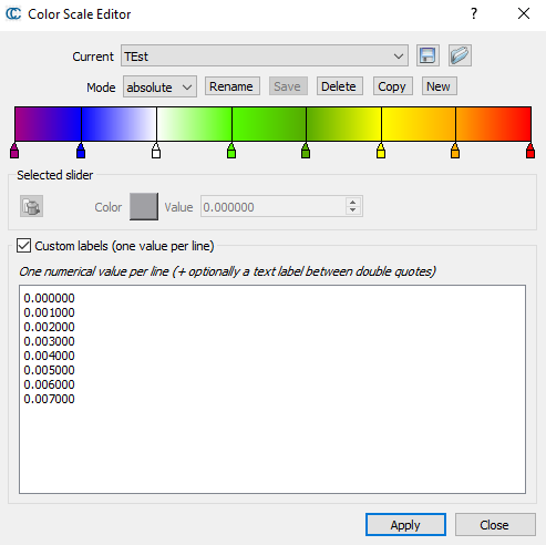

Hello Daniel,
I tried to create a color scale like you did. But my color scale only changes the colors through the gradient.
How can I create a Color Scale withou the gradient.
Thank you.
You have to create two 'steps' very close to each other (e.g. 1.0 and 1.0001)
