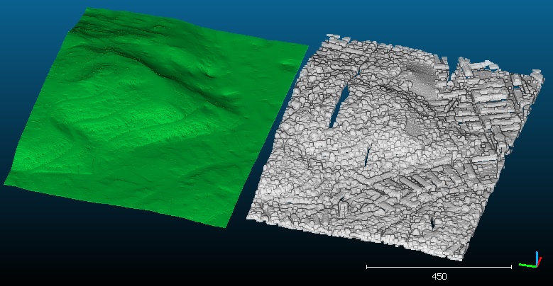

I also added an option to export the cloth mesh at the end of the process (I was curious ;):
