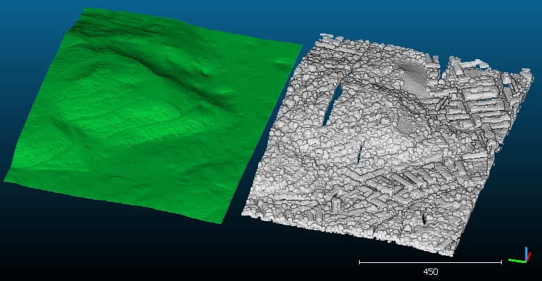

I just updated the plugin (same link as before):
http://www.cloudcompare.org/release/Clo ... bin_x64.7z
I used CC's octree instead of CGAL. On the rasterize and distance calculation steps, it goes almost 10 times faster (
also because CC's octree is doing things in parallel). CC's octree could be even faster if it was able to work in 2D, but sadly it's 3D only for now.
You can still revert to the old code by checking the 'QCSF_CGAL_SUPPORT' option in CMake).
I also added an option to export the cloth mesh at the end of the process (I was curious ;):
- CSF_cloth.jpg (111.29 KiB) Viewed 296916 times
And regarding your last questions, I compared CC's with 2 other algorithms during my PhD and my Octree was faster. However it mainly depends on what you want to do. CC's octree is very good when applying a process on the whole cloud (which is exactly what we do when computing distances, etc.). But it's not that good for random queries done on a few points only.
I know flann and ANN are very popular. But I feel they are too generic to be very efficient (especially on big point clouds). They are still very good tools when developing code outside of CC.
