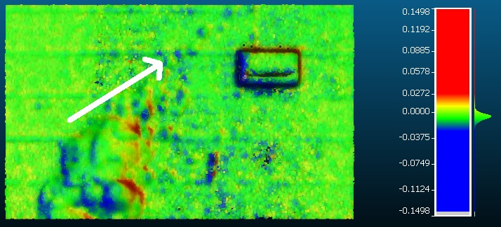

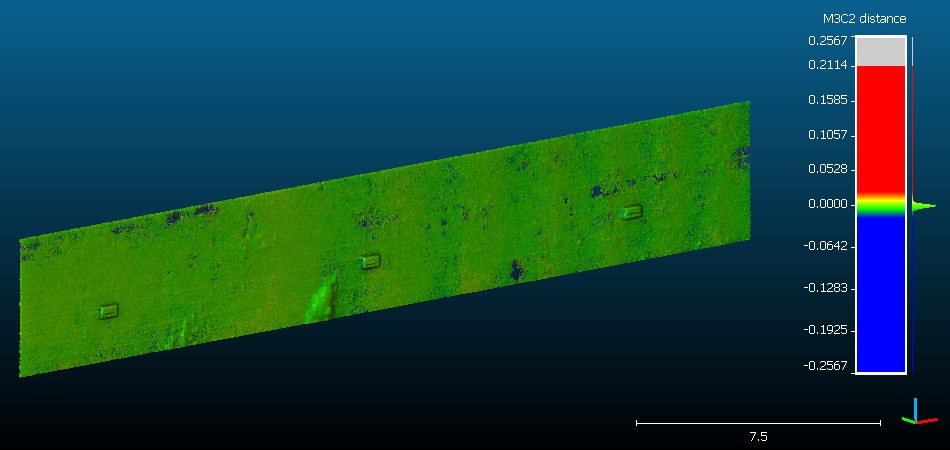

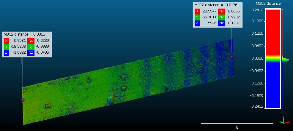

Then I computed the M3C2 distance to see what happens at 7 am and 10 am.
7h
M3C2 distances 7h / 6h
10h
M3C2 distances 10h / 6h
The pattern we can see at 10h is a radial pattern, with a center approximately on the left of the wall (I guess it was approximately the point in front of the sensor?). This pattern is typical of a sensor artefact or even a calibration issue. And you get the same at 13h (I haven't tested the others).
Regarding why you didn't see the pattern before 10 am... there are several possibilities:
  • the sensor was not 'hot' enough? If we increase the scalar field contrast, we can see some ripples... but very small compared to the ones at 10h.
  • the sensor did move (even a little). Considering the distances and the small variations (the sensor was at least at 50 meters from the wall, while the variations are mostly below 3 cm), even a very small change of attitude of the sensor will have a big effect on the result. Especially we can clearly observe a global shift between 10h (or 11h) and 6h (mostly along Z, but also along X). To test this on your side, simply display only these 2 clouds, and then toggle one cloud on and off quickly.
    M3C2 can clearly detect it (here on a small part where it is the most visible):
    M3C2 distances 10h / 6h (closeup)
    This issue might be disconnected from the pattern one. But it may increase the effect.
  • another option is that the scanner behavior is very unstable in time (was it in a shaded area or directly hit by the sun? etc.). Remember that the displacement is very small compared to the distance. And did the wall lighting conditions changed a lot during the day? I know some scanners are quite sensitive to this.

what are your parameteres when computing the M3C2 distance. i tried it with different settings but never managed to get the same result like you. and how can you select these 2 points like you did in the picture "M3C2 distances 10h / 6h". you are right left side was approximately the area in front of the sensor.

2) For M3C2: normal radius was 0.1, projection was 0.05 and max dist something like 0.25. The important parameter is how CC will deduce the correct normal orientation: as we are lucky enough to get the points directly in the sensor original coordinate system, we can use the '+(0,0,0)' preferred orientation (in the 'Normals' section, bottom 'Orientation' frame).
And I used all points for the computation (no subsampling, there's not so many points).
Then you have to hide the original clouds (M3C2 creates a new cloud by default). And you have to change the distances SF saturation to be able to see the pattern (reduce it to something like 2 or 3 cm).
3) Trusting the M3C2 results, we can see that most of the distances are below 3 cm (I used as a very coarse approach the 'Normal distribution' rule of thumb: 1 * std. dev. = 68% of points below / 2 * std. dev. = 95% of points below - even though the distribution is not exactly Normal/Gaussian ;). And of course a good part of these distances are probably due to noise and not to an actual change of the wall...
