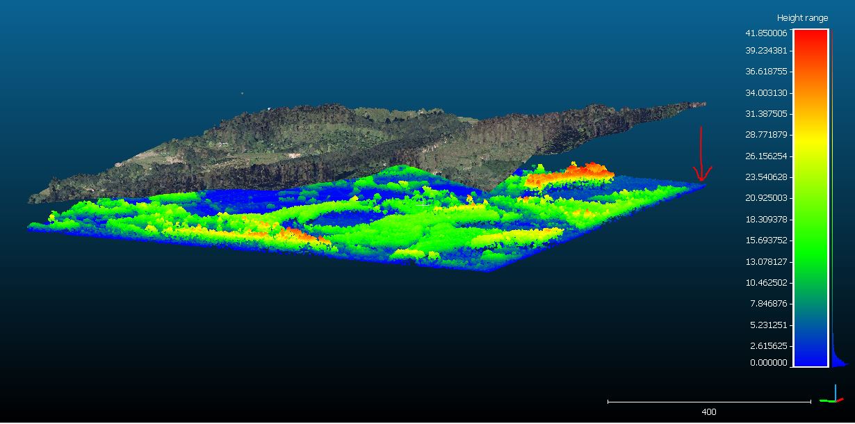

1) use the Rasterize tool: if there's enough ground points below your vegetation (i.e. a good lidar cloud with enough penetration) then you can simply rasterize the cloud and export the resulting grid as a cloud exporting the 'height range' scalar field:
If you have both ground points and vegetation points in your cloud, then you'll get in this scalar field the difference between the two. You can then export scalar field as the Z coordinate:
2) if there's not enough ground points (i.e. there are holes in your ground cloud), then you'll have to fill them by triangulating the ground points first (e.g. with the Delaunay triangulation tool, or with the Rasterize tool once again, by using the 'Interpolate' mode for the 'fill empty celles' option). In the first case, you'll have a mesh that you'll need to convert to a dense cloud (Edit > Mesh > Sample points). You can then either merge the two clouds (filled DTM + vegetation) and use the method described above (1). Or alternatively use the 'Compute 2.5D Volume' tool that does the same but between two separate clouds (you can export the 'difference' raster directly)

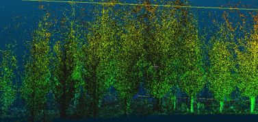

I figured out what was going wrong. I wasn't activating the "Scalar Field" in the properties Scalar Fields section. I have made the dsm. The problem I am having now is that all my trees are being stretched in the Z dimension. Have you seen this problem before?

Re: DEM
What am I looking at?!
Are you sure you are projecting along the right dimension? Or using the right scalar field?
