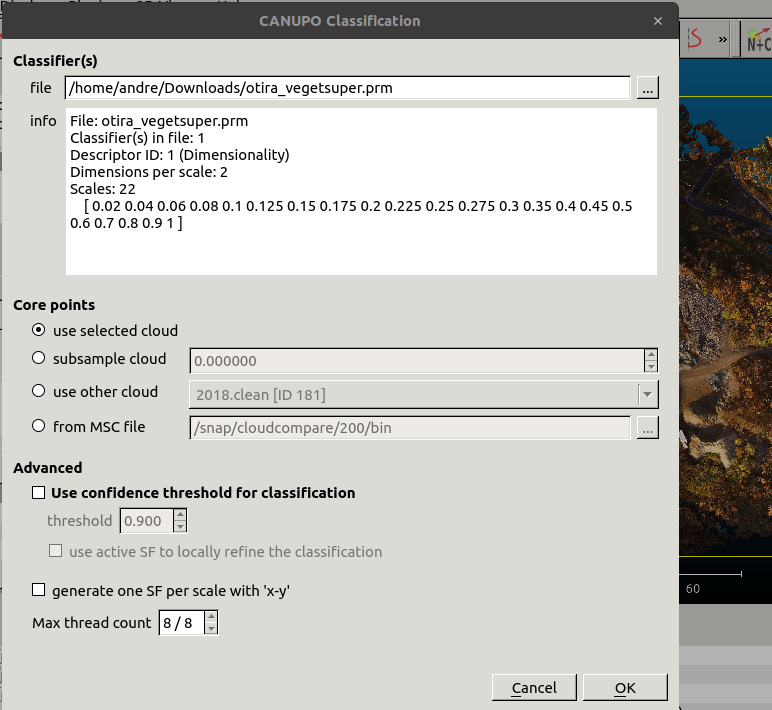

So I am testing on 2.10.1 , I have also tried the "vegetTidal"
Screenshot from 2019-02-28 16-15-14.png (181.51 KiB) Viewed 259256 times
press "ok" , it works for a few minutes, then crashes.
-metric data, metric .prm files.
how to troubleshoot ?
