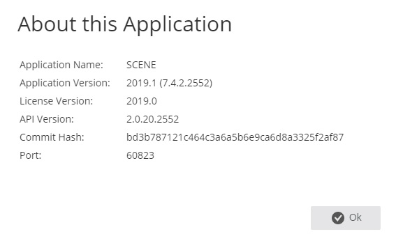

Ok, I replaced the 1.1.505.3 with 1.1.701 in the manifest, but it appears to have no effect.
However, I've tried a bunch of different LSPROJ files and some of them load. My guess is that LSPROJ files created with the latest version of FARO Scene are getting the "no workspace" error. I see that you mentioned that the newest FARO LS is 1.1704.x. How do I get that? Google did not help. Can you include it with your CC installation?
The LSPROJ I got to load is over a year old.
One last thing I noticed is looking in C:\Windows\WinSxS\amd64_faro.ls_1d23f5635ba800ab_1.1.701.1_none_3591adaf356ae9b1
(that's the only FARO folder in winsxs)
There is no xerces-c_3_2.dll
Only a xerces-c_3_1.dll

Indeed the '1.1.701.1' version doesn't depend on the xerces-c_3_2.dll file, this is why I chose to roll back to it so as to avoid the conflict with GDAL...
But it's one year old at least, so you are probably right, it might not be able to load more recent FARO files... And one of the previous version of the 2.11.alpha (installer) version was incorporating the latest SDK (FARO LS 2019.1.2.2552 x64 Setup). But it was the version that was conflicting with xerces-c_3_2.dll...

My friend is using CC 2.10 beta (FARO LS 1.1.503.3), and FARO scene 2019.0.
Strangely he has been able to open my LSPROJ files created with the newest version of FARO Scene 2019.1.x?
