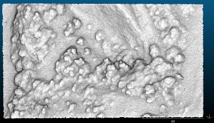

Can you show how your cloud looks like whithout colors and with the EDL shader for instance? (you may have to increase the size of the points)

Yes, of course.
Here it is....
Here it is....
- PC_EDLshader.jpg (151.69 KiB) Viewed 229539 times
Hum, once again I'm not an expert, but this cloud looks quite "smooth" ('lumpy' may be a better word ;). And on the contrary it's quite noisy/rough at very small scales (the EDL shader is very good to spot the noise).
However the large scales (~5 and more) should still be quite discriminating. But it's hard to 'capture' the boundaries with such large scales. And the smaller scales won't help you much as the cloud is a bit noisy...
Maybe Dimitri would have a trick in this kind of situation?

Hi Bruno,
answer before I saw the picture:
the downside of use point clouds from SFM is that you have little penetration into the canopy of vegetation. With lidar, even single echo like TLS, you always have points in the vegetation, such that vegetation appears really 3D at relatively small scales. With SFM, vegetation appears 3D at larger scales (i.e. , a bumpy surface) which translates into a classifier of lower resolution, and much more difficulties to correctly identify ground surfaces. I did a test a few months ago on exactly the same scene measured with ALS, TLS and SFM, and the classification of vegetation with SFM was much more difficult, resulting (obviously) in big patches of ground missing compared to ALS or TLS. But it was still feasible with qCANUPO. You just need to adapt the range of scales.
After I saw the picture : ok,that's going to be very tricky. Roughly, you'll be able to tell apart flat areas from bumpys areas but not much more, because even a trained human would have trouble distinguish vegetation from ground (and a trained human eye is still better that qCANUPO ;-). Moreover, it seems that you're working on a hilly area with sharp edges which may pose some trouble too. My best bet would be to look at the RGB field to see if you can use it. Recall that there's actually no groung points below the vegetation, so reconstructing a topography from such sparse data will results in largely uncontrolled interpolation. SFM is great, but not for vegetated area...there only TLS or ALS can really see through vegetation.

Thanks for your guessing Daniel, you were right after all! :)
And Dimitri - even if you called me BrunO...it's BrunA, but its okay, no problem :) - thanks so much for your explanation, I was thinking that it could be a problem with the model and its density, and I'm now totally agree with you that is all about the SFM reconstruction.
As you said, we can do this caracterisation with point clouds generated by photogrammetry, but in fact the vegetation doesn't look like a 3D thing in small scales - what made me choose bigger scales and what took long time for calculation.

Forgot to say: In the other hand, I opened a topic asking for a "color classification". I doesn't work, because some parts of the cliff and some bushes that have the same RGB color (same values to the Green channel). So, deleting this value from the Green channel will also delete some parts of the cliff. So no, it doesn't work for this model at all.

RGB classification: it's very rare to be able to use it due to shadow effects (especially when you have... vegetation ;-)).
Now, maybe by going back to the actual dense point cloud reconstruction phase and trying to be less strict on the depth processing this could help. My idea: you might actually have more noisy points on vegetation than ground, and this could be a feature that qCANUPO could use.
