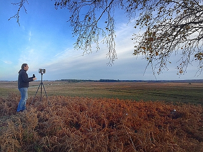

Not a great photo, but the site looked like this
IMG_0261 (2).jpg (141.44 KiB) Viewed 253477 times
My colleague is standing on the top of a tumulus, the ground falls to the right....I'm taking the picture by a tree.

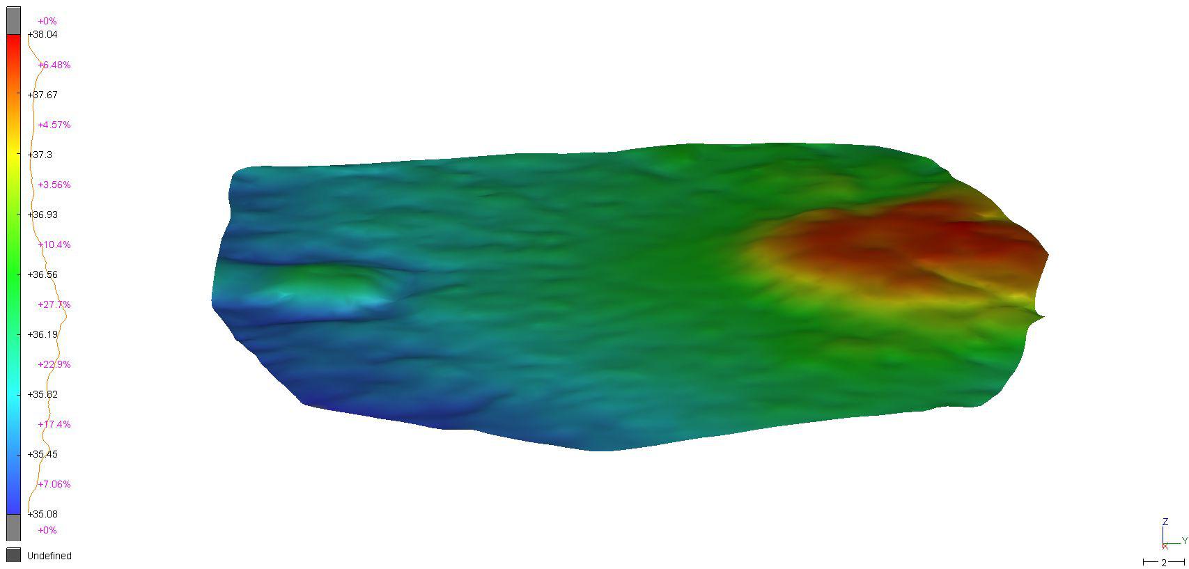

The final meshed data, looking from the other side of this scene, with the tumuli now on the RHS looks like:

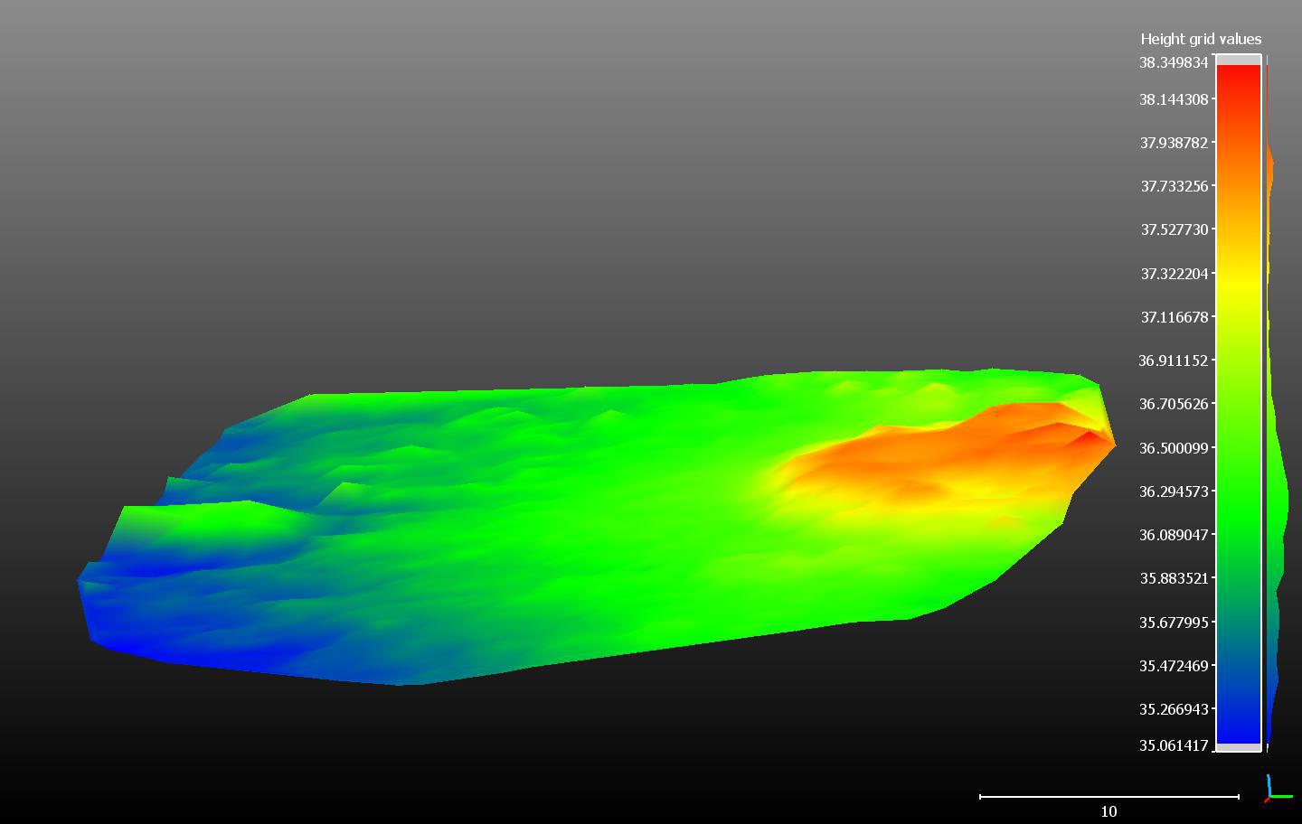

I also processed the data in a trial of 3d Reshaper, using their Ground Extraction algorithm:
If you can spot anything obvious I may have missed, or you don't think the results look that great, please say....I am quite new to this!
Cheers!

sorry for my late reply. As I suspected this is typically a case where CANUPO won't help because there's no way the scanner (and I'm using the same X330) hits the ground. Hence, beyond large trees and big vegetation, the only solution it to derive a lowest point DEM or mesh (the 3D reshaper processing looks nice). Scanning in winter would help to get as little vegetation as possible. Alternatly you might want to try the lasground function from lastools (free for small datasets) if you have several dataset to batch process.
