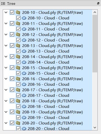

Hello, Daniel.
I'm processing many files, scale unit from mm to m and then export to another file format. Could you add function of multiply/scale (including option of keep in place) into command line mode when update beta file this time?
Another possible way is to save point clouds into separated files instead of saving all point clouds into one file, even when all point clouds are selected (as seen in screen capture below).
If it is not easy, just forget it.
