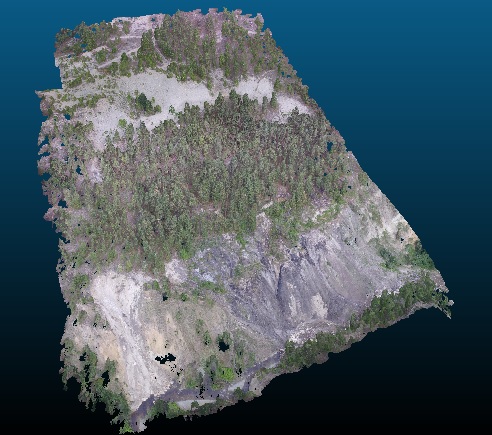

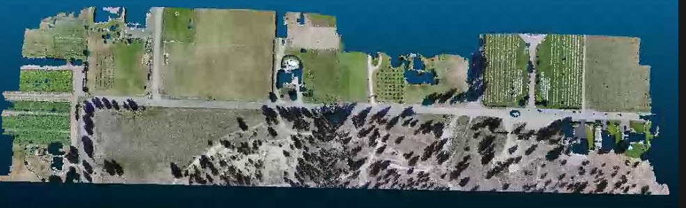

Basically I'm a geotechnical engineer and I'm interested in extracting bare-earth models for slope and other analysis. I've used qCANUPO to classify my point clouds, however, I couldn't figure out how to separate/delete vegetation from the ground (bare earth) points after classification.
I really want to see and export (as laz or laz, dwg) a colored (point cloud has sRGB properties) bare-earth model after classification. Or if there's is an option where I can check or un-check the vegetation after classification. Please see attached images for reference.
I'll really appreciate a quick response.

Once you have generated the classes (as a scalar field), simply use 'Edit > Scalar fields > Filter by value' (and set the interval corresponding to the right class).

Hi Daniel, thanks for your reply. In values what should I enter for minimum and maximum?
@wpqjbzwm, Thanks for the info. I'll definitely try CSF as well. In my opinion VR Mesh is the best in terms of options and outputs, however, I'm also impressed by qCANUPO. As scalar field after classification, it appears to me that qCANUPO classified trees and bushes well. However, I still have to see how the bare earth looks in RGB. That I could only see after I'm able to separate the vegetation from ground points.wpqjbzwm wrote:Hi, @uasghar.
For bare-earth extraction, there is another option. You may try new CSF plugin. (see http://www.danielgm.net/cc/forum/viewto ... =21&t=1724)
Hope to see your comparison of qCANUPO and CSF. I guess qCANUPO should be better, because it uses more information to classify ground and non-ground points. But CSF will be easier to use.
Simply the class you want to extract (the same value twice).

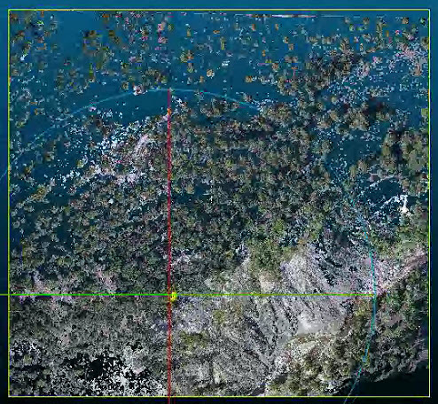

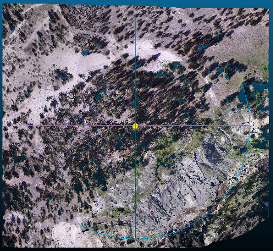

For flat to generally undulating areas, the results have been amazing I've extracted bare earth model, that is good enough for my project (Figure 1). Area looking black are actually tree shadows and not trees. However, for relatively steep slopes with thick tree cover and/or surface erosion debris, there're certain points which were classified into vegetation but actually correspond to earth/ground, e.g. For one such area in the project site, post classification results are shown in Figure 3 (Bare Earth) and Figure 4 (Vegetation).
In Figure 4 you can see that there points (white/brown) that should've been classified as bare-earth but weren't. Could you guys suggest what is the pblm here? The scale for my classifier varies from 0.10 to 25 with a step of 0.20. I've used upper limit to be 25 because there're certain houses on project site that are close to 25m in length.

I've classified a very large photogrammetry based point cloud (approx. 280 Million points) using qCANUPO. I constructed my own classifier using trial and error in Train Classifier and I really take this opportunity to thank you guys for your work, especially because you've made it open source.
