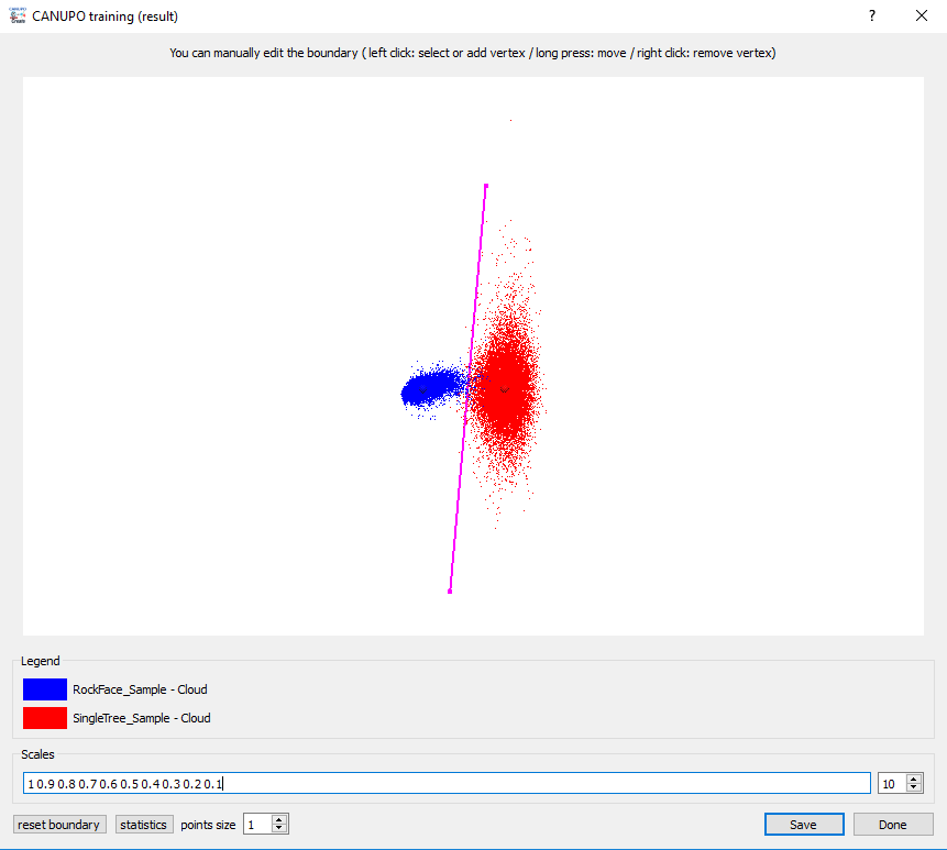

I have been using the Canupo plugin for my MSc Project. One of the things I have been asked in review of one of my chapters is exactly what the X & Y axes show on the graph which displays when you train a classifier?
I have attached a picture below so you know exactly what graph I am talking about. There are no X and Y axes labels included. It would be good to have an understanding of exactly what the graph is showing.

If I remember well, the two main axes are obtained by a kind of PCA analysis (https://en.wikipedia.org/wiki/Principal ... t_analysis). The Canupo descriptors are corresponding to vectors with a lot of elements (2*N, where N = number of scales). The classification is therefore done in a 2N dimension space. This would be impossible to display it in 2D, so the plugin projects the vectors along the two main components (obtained by PCA) .
It may be a bit simplified, but that's the spirit ;)

So am I right reading the graph I posted that there is greater variation in the Principal Component 1 (along the X-Axis) than along Principal Component 2 (along the Y-Axis), hence a more vertical plane of separation, or the other way around?
Furthermore, Once classified, how is the Class Confidence calculated? And I take it the value essentially means the classifier is (e.g.) 95% (0.95) confident that this point is classified correctly?

The difference between the two first principal components may be very small (as they are the two most important ones), but I guess it's right to say that the first one is bigger than the second one.
Mind that they are internally computed and you don't have access to the Eigen vectors, so it's a bit 'arbitrary' in a way. It's mostly a way to represent things in a user friendly way, and to let the user update the boundary manually (you can add and move the vertices boundaries in this 'plane').
