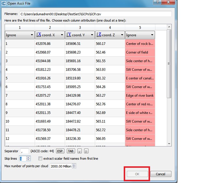

But how do i insert these points on the point cloud? Because when i import these file it is not letting me click on ok.The screen shot is attached here.This shows what is happening.If we notice the image ok button is greyed off.I have the point cloud selected in the background then i am trying to import these points onto the point cloud.Point cloud is also attached.

Oups, I think this is a small glitch (as the column is 'ignored' so CC should let you click on ok!).
Can you simply remove the last column from your CSV file maybe?

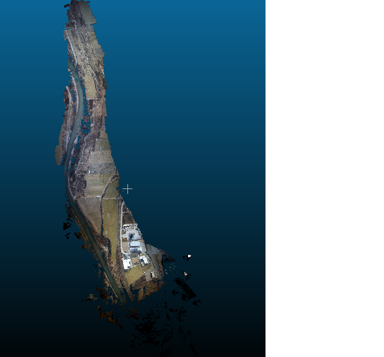

I am now able to import these GCPs as GCP pointcloud but i want these GCPs to be pointed on the point cloud i had attached earlier.
How is that possible?
Image 1
Image 1
gcp point cloud.png (3.02 KiB) Viewed 23789 times
Re: Inserting GCP'S using Cloud compare
Well, you can merge the two point clouds (select both of them then use 'Edit > Merge'). Or do you mean something else by 'pointed'?

no i just want these points to be shown on the point cloud so that i can continue further with the evaluation.
Well... you could increase their size and change their color?

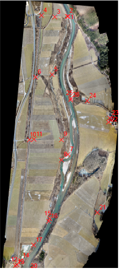

well merge option does not seem to be working in my case.I would like my results to look like the one attached below.This was done using photoscan. All the 26 GCPs are pointed on the orthophoto.

renu
Posts: 7
Joined: Tue Oct 28, 2014 10:42 am
Post by renu »
I also tried synchronise option but that also does not seem to work..Please help
