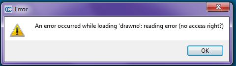

a) Whenever a las/laz file is in a folder or path containing an accent, the las/laz file opening fails! This happens only with las/laz files AND whe trying to open them in 2 different ways: from the open menu in CC, double-clicking in the windows explorer, dragging in an already open CC GUI. The CC message is as follows
Error mesage CC_1.JPG (19.82 KiB) Viewed 4773 times

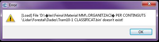

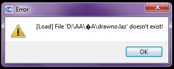

b) When trying to open any formated file (including .bin) stored in path containing accents BY DOUBLE-CLICKING on it, CC warns me that the file doesn't exist:
Error mesage CC_2.JPG (17.05 KiB) Viewed 4773 times
Error mesage CC_3.JPG (21.41 KiB) Viewed 4773 times
If I'm trying to open any file except .las/laz, I only need to drag it into an open CC GUI instead of double-clicking regardless the path contains accents. However, if I'm opening a las/laz file, dragging causes the error described in a) so I have to move it to an non-accented path...
