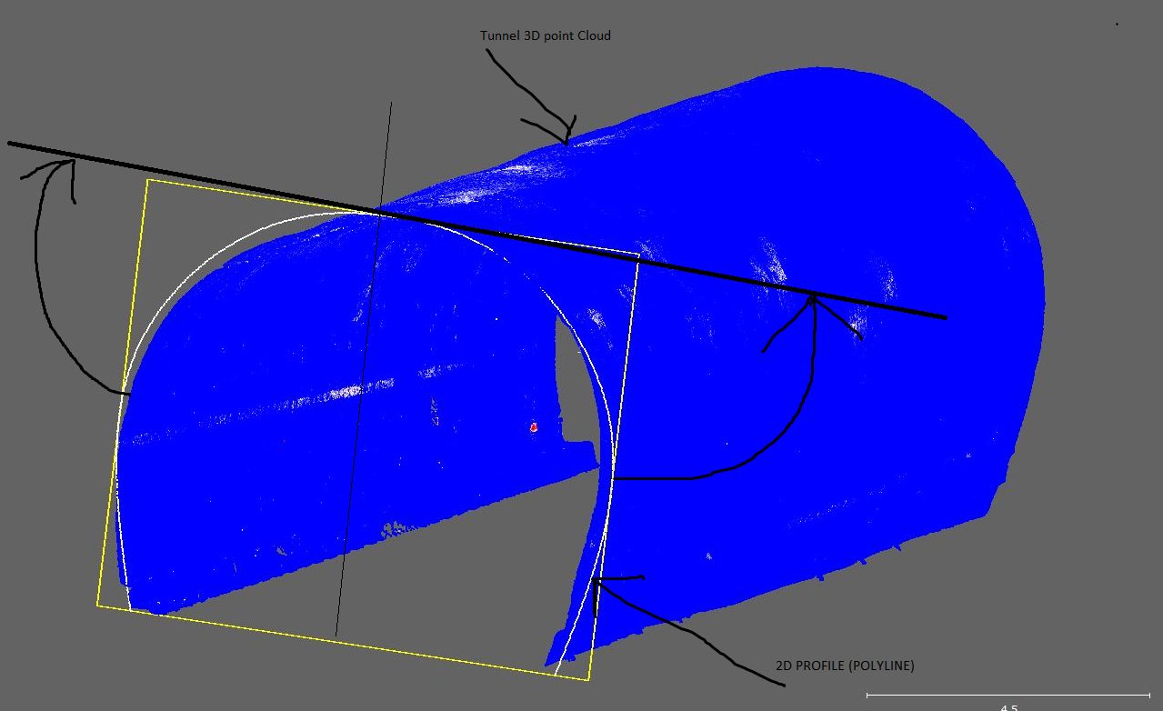

Thanks for answer. I found, probably 2D imported polyline should be enough. Now, there is another problem. How to create map from that two parameters. When I try to create map with deviations, something wrong happens. Is the map creation possible in my case? The problem is attached.
- Tunel.jpg (70.77 KiB) Viewed 10486 times
Re: Surface of Revolution Analysis
Well, the qSRA plugin is for a 'surface of revolution' (i.e. a surface obtained by rotating a curve around an axis - see http://en.wikipedia.org/wiki/Surface_of_revolution).
In your case it's more an extruded shape. I'm afraid this plugin won't help you with that...
