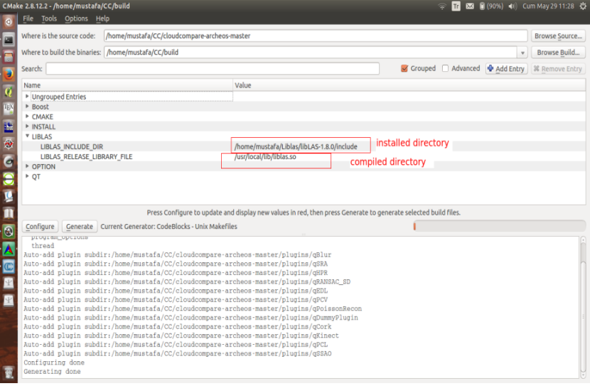

I have compiled and installed liblas. But I got an error
WARNING: Target "QCC_IO_LIB" requests linking to directory "/usr/local/lib/". Targets may link only to libraries. CMake is dropping the item.
WARNING: Target "CloudCompare" requests linking to directory "/usr/local/lib/". Targets may link only to libraries. CMake is dropping the item.
WARNING: Target "ccViewer" requests linking to directory "/usr/local/lib/". Targets may link only to libraries. CMake is dropping the item.
I think I am showing the folders wrong to CMAKE. Which folders are need to enter there? compiled (builded) files of liblas? or in \usr\local\ lib ?
I am confused.
Thank you.
Re: Opening las/laz files
Posted: Fri May 29, 2015 6:43 am
The LIBLAS_RELEASE_LIBRARY_FILE must point to the actual library file (.a or .so on Linux). When you 'install' liblas, look where it is copied (I guess it is indeed in /usr/local/lib but you must add the right library file at the end of the path.

by muzo583
Dear Daniel,
Thank you so much. Now, I can import Las files.
