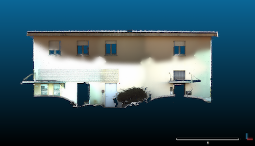

Hello Daniel,
I would like to create an ortho ( .tiff ) of a facade detected by laser scanner . It would export it already scaled in such a way that when the amount in autocad I find already scaled .
you can do this ?

There's some useful information in this post:
viewtopic.php?t=1428
The main idea is to use the 'Adjust scale' tool (http://www.cloudcompare.org/doc/wiki/in ... djust_zoom).
