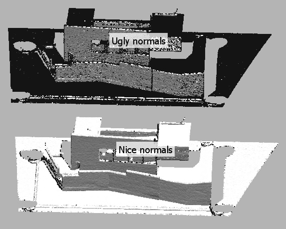

1. Here is what nice normals should look like:

And regarding your cloud: it's quite noisy so you'll have to denoise it a little bit first in order to get not-too-bad-normals (you can increase the points size to see the noise). You can use the SOR filter to do this (see 'Tools > Clean > SOR filter' - leave the default parameters). Then compute the normals and when asked about orienting the normals, say yes and use a low number of neighbors (3 for instance). Here's what you should see:
(note that it's not perfect yet, but it's hard to get a better result with a noisy and incomplete scan, especially on the front part where the two sides are very close and almost 'connected' due to the noise)

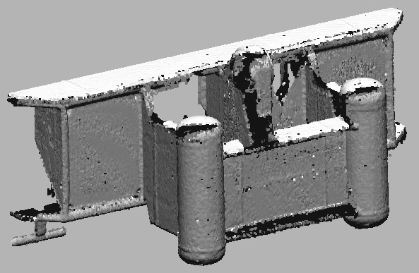

And here is the result with PoissonRecon:
You could use the density information to remove the bad parts (see http://www.cloudcompare.org/doc/wiki/in ... n_(plugin)). But it would be better to get rid of the noisy parts prior to use PoissonRecon (maybe with the scissors tool?). At least you should get the idea.
