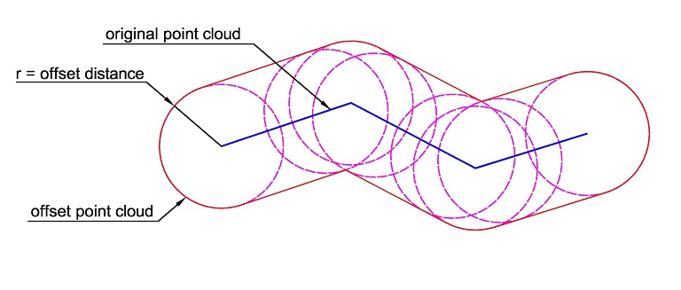

I want to know if you can add an offset tool for point clouds.
in other words, for each point of the original cloud, you have to create a sphere and then add up all the spheres and find a cloud that encloses everything
Alberto
Alberto
- offset.jpg (74.29 KiB) Viewed 18857 times
Re: offset tool
All the magic is in 'find a cloud that encloses everything'... How would you do that?

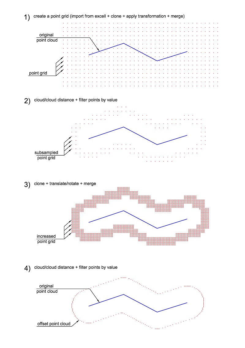

Thanks for the quick answer.
This is my current solution, is slow and inaccurate, I hope you can improve it.

The only thing I could reasonably add is a method that would expose the Distance Transform of the point cloud. This is a grid with the distance to the nearest point in each cell. You would be able to choose the grid step. And then you could extract all the points (= cell centers) that are at a given distance to the cloud.
