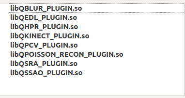

I have a dense (few million points) point cloud, and i have it stored in .xyz normal x normal y normal z format. I wish to convert this to .pcd file. I read that I can use the PCL plugin cloudcompare for the mentioned operation. However in my Cloud compare I dont have pcl plugin. I have attached a screenshot of that. I could not find the plugin as well. Kindly if some one can help? I need the .pcd files for my research purpose.
plugins that are present

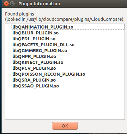

I have installed 2.6.3 now, but I still dont have the PCL plugin. I have more plugins but not the one I want .
Re: XYZ to PCD
Hum, I must have missed something with the latest Linux integration... Then you'll have to compile CC yourself with PCL support (or use the Windows version ;).
