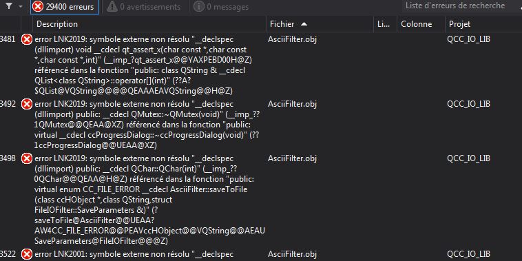

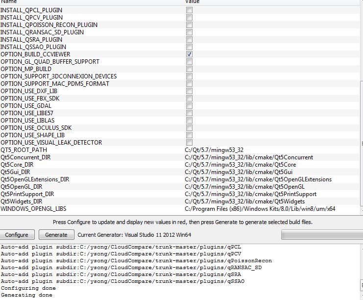

I have compiled successfully CC. But when i generate the project "CloudCompareProjects.sln". I have a lot of errors
I used Qt5.7 vs2012 and CC2.7. It's caused by their incompatibility.
Thank you in advance for your response

I changed the version of CC(2.6.3.1) and Qt(4.86) and I had fewer errors
Re: Problem for compiling CloudCompare
In the first case: you were not linking with Qt for Windows 2012 but for MinGW (see the QT5_ROOT_PATH ;) ). I'm not even sure Qt provides Qt 5.7 for MSVC 2012 anyway... Moreover CC 2.7 requires a C++x11 compatible compiler (i.e. MSVC 2013 or newer).
And for the second case: hard to tell... can you post the console log instead?

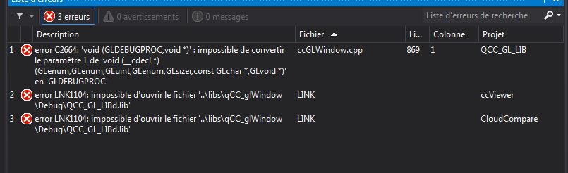

Oh, it's for the GL_KHR_debug extension, it's not important at all.
You can comment the whole section:
if (ccFBOUtils::CheckExtension("GL_KHR_debug"))
