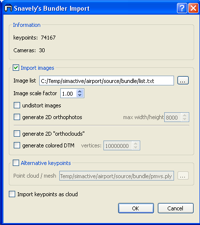

I am trying to import a bundle.out file into CloudCompare V2 04/25/2012 on Windows but am encountering an error saying
"BundleFilter:loadFile] Failed to load image xxxx.jpg'! (check your list file and be sure to put images alongside)
The files are actually there but the import isn't going through.
Does anybody know what is going on and how can I fix it?
thanks
Snavely's Bundler Import error
- Error message
- bundle02.png (6.91 KiB) Viewed 15495 times
Re: Snavely's Bundler Import error
if the image is in the folder 'C:/Temp/simactive/airport/source/Bundle'n then it must effectively be something else.
However, the only other reason would be that Qt fails to load the jpg file:
- you may check the version of the 'qjpeg4.dll' file (in the 'imageformats' subdirectory of CloudCompare) --> the date must be 08/12/2011 and its version 4.8.0.0
- try to open it and save it again with a very classical software such as Paint?
- otherwise you can send me one failing file and I'll try to reproduce the issue
