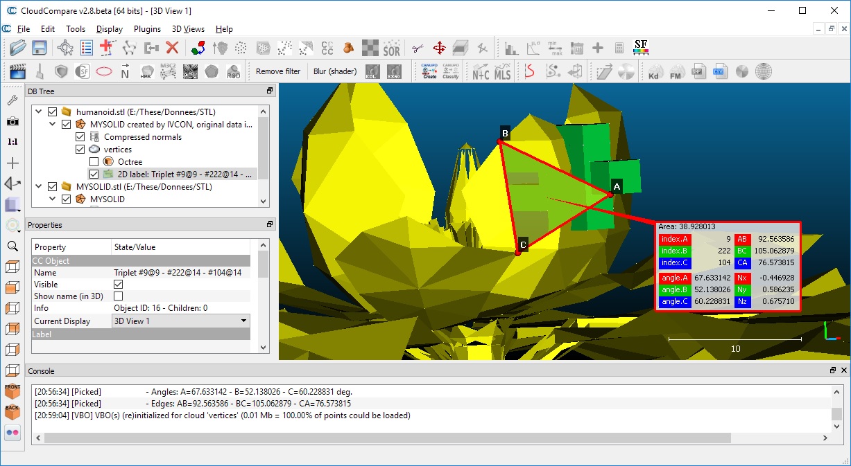

This issue has just re-occurred again (I thought it must have been me!), but its definitely present in a few of my currently open files.
A bit more info:
After creating a 2D label (angle measurement in my case) the label does not appear in the tree under its respective cloud.
The 2D label cannot be selected in the graphics window.
Exiting CC and reloading (after a save of course) it then DOES appear in the tree, but if selected in the tree it goes red in the graphics window - but it cannot be moved. It still cannot be selected in the graphics window.
I'm using 2.8 Beta. There are STL derived meshes in the file, a primitive and some saved viewports.

Is the angular label shared by multiple entities? And is it the latest beta?
I tried on my side and I couldn't reproduce the issue (I used STL meshes - just in case ;) - and I made the label span over the two set of vertices).
