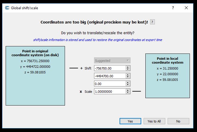

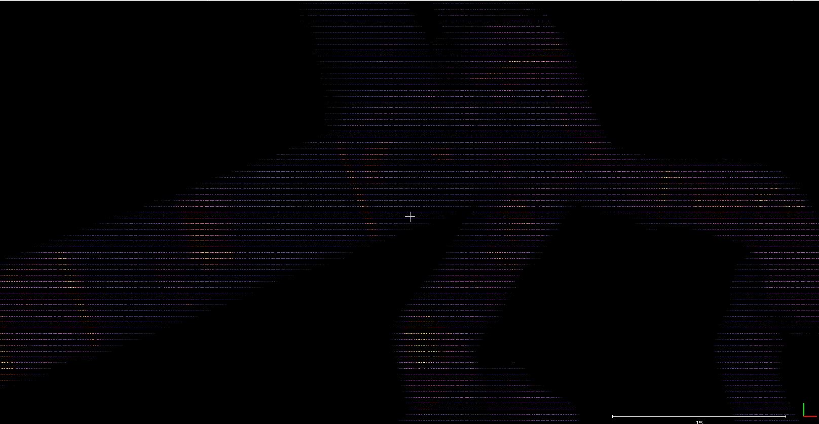

in the last recent versions I noticed a visualization problem with a lot of digits, like WGS UTM 84. In the past versions if I chose to applicate a Global shift/scale (coordinates are too big) the viewer of the points was correct. Now, the visualization is sliced like the attach photo. Is the same if I answer yes, yes to all or No
Thank you

It is directly exported from Photogrammetry software in WGS 84 UTM 33N.In Photoscan it is correctly viewed. How I can see if is a problem of exporting file?

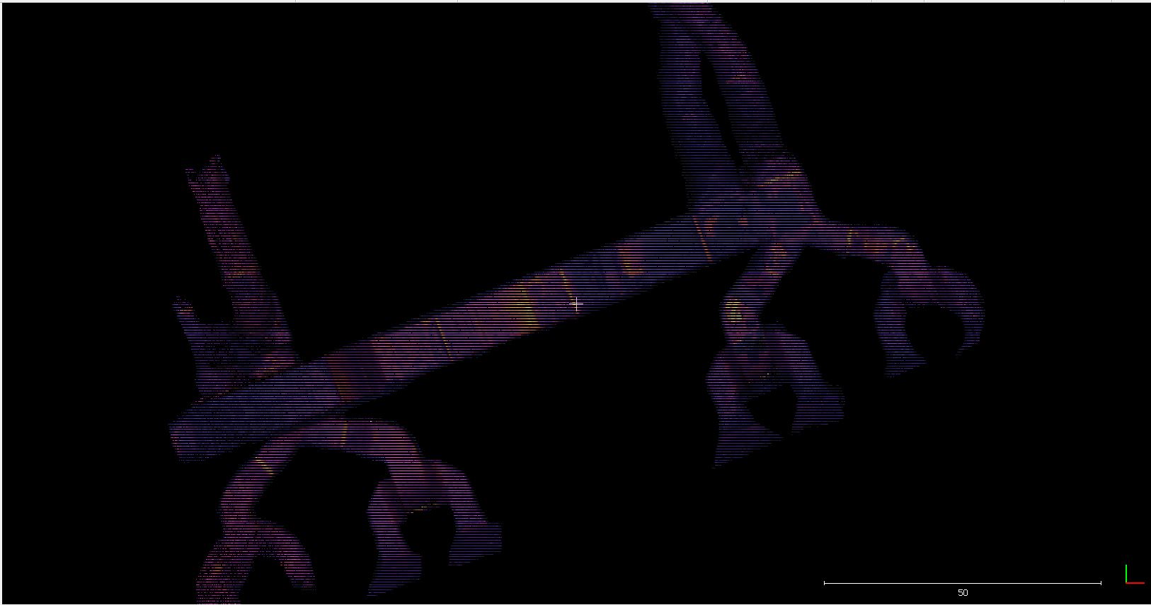

AFAIK it's an issue with the export of PLY files generated in Agisoft. Try using the shift settings when exporting from agisoft, that should solve the issue.

Ok Aarie, but I need the correct coordinates and not in local. I knowed that in Local coordinate there was not problem, but I did not think in a exporting problem
