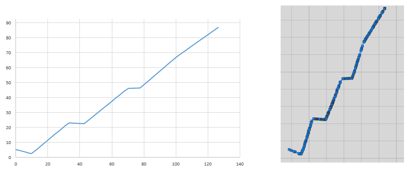

Hey all =)
i've recently extracted some profiles form a point cloud.
Easy as pie (congrats!)...
but i struggled with the export of the data !
I would like to import the profiles in another program which asks for 2D data ( XXX/ZZZ )
Export into a *.dxf file results in a properly scaled dataset ( see right image, AutoCAD w/ ortho view on the side of data )
Export into a *.csv file results into a somewhat warped dataset ( LEFT image, excel ..quick and dirty..)
the Z data if correct only the Curvilinear abscissa seems to be warped.
What do i miss ?

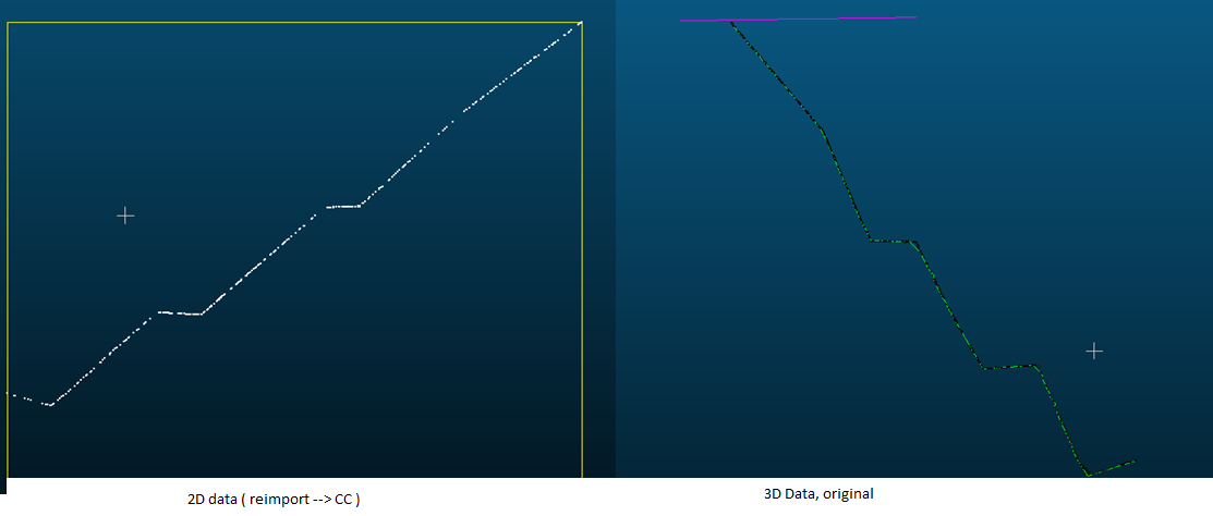

Re: profile extraction / export
Hey =)
thanks for looking into the issue!
AutoCad displays the data correctly, so no issues there. The problem must lay within the *.csv export.
I've reimported the data into CC and below you can see the result:
right image -- > original data
left image --> warped reimported csv file
I'll attach the files for better comparison.
cheers
Huh, how did you exported the polyline to CSV by the way?
Have you used the 'Height profile (*.csv)' filter? Because this 'height profile' is actually: the curvilinear abscissa in the first column, and the corresponding height in the second column. So definitely not a 2D / 3D export of the polyline ;)
Ohh ... :-/
yup, was using the "Height profile" export, it just sounded to tempting..
That explains the issue.
But is there another option for my 2 dimensional needs ?
Thanks again for looking into this.
cheers
cheers
Well, if you were happy with the CSV export, you can simply export the polyline 'vertices' (which is a point cloud entity below the polyline entity in the DB tree) as an ASCII/text file. You can even configure it to look like a CSV file with the ASCII export parameters dialog.
