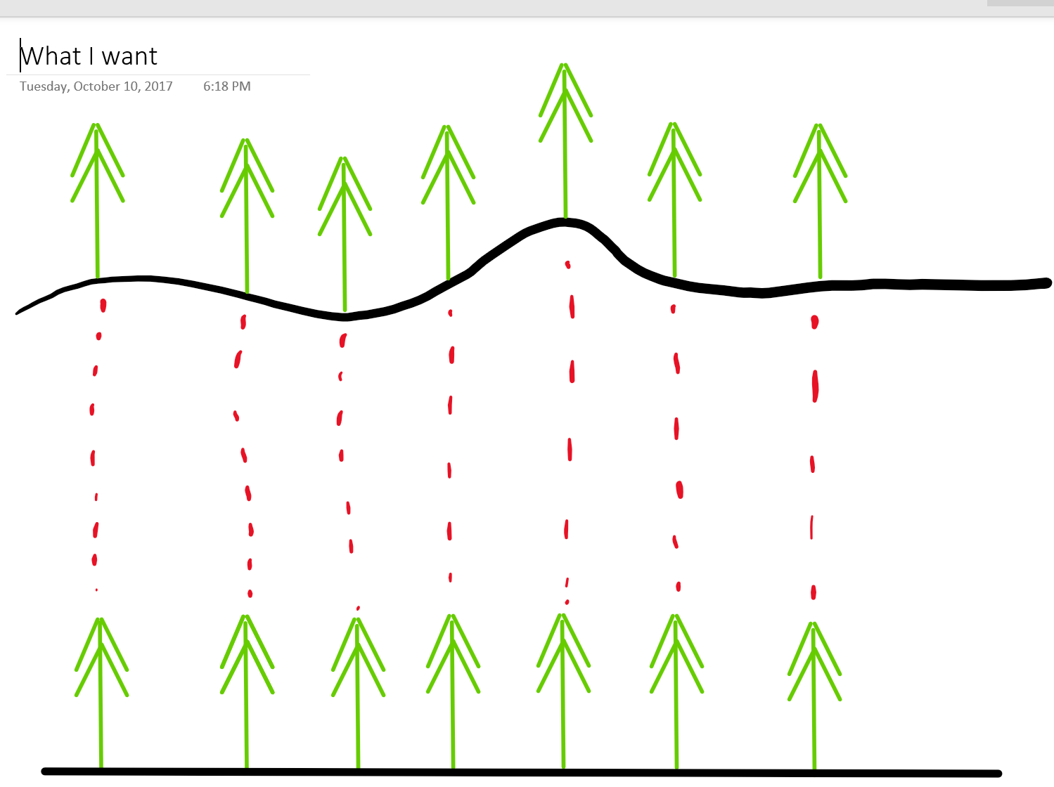

I attached a photo of what I am trying to do. I don't think we are understanding each other. Thank you for your time and patience.

cdordoni
Posts: 30
Joined: Wed Sep 30, 2015 3:19 am
Re: DEM
Post by cdordoni »
Daniel,
DEM is a general term that is used for both DTM and DSM data.
https://www.gisresources.com/confused-dem-dtm-dsm/
The true ground surface is obscured by trees or buildings, so when the trees and buildings are removed, there are holes. To create the DTM, the holes are filled in.
To get the actual surface (DSM) including the trees and buildings, that data has to be added back in.
