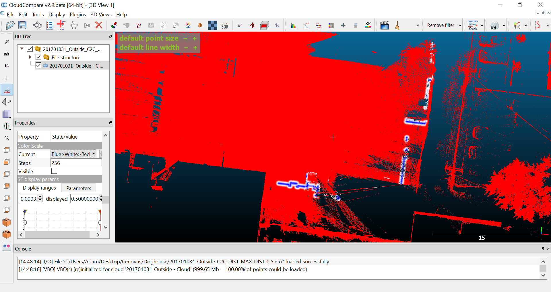

This process works fine when I use the GUI. However, when I replicate this in my command line, I get wildly different (and incorrect) results.
GUI (correct): https://www.dropbox.com/s/v4v53v1k4znn426/GUI.png?dl=0
Command Line (incorrect): https://www.dropbox.com/s/5ggvv4qre8azc ... e.png?dl=0

So, I did some more testing with the command line. I ran the same command line, but with "global_shift auto" after the open command. Both of these attempts produced the same results:
Two uses of global_shift auto: C:\Program Files\CloudCompare\CloudCompare.exe -silent -auto_save off -O -global_shift auto C:\...Cloud1.las -O -global_shift auto C:\...Cloud2.las -remove_all_sfs -c2c_dist -max_dist 0.5 -C_EXPORT_FMT E57 -no_timestamp -save_clouds
One use of global_shift auto: C:\Program Files\CloudCompare\CloudCompare.exe -silent -auto_save off -O -global_shift auto C:\...Cloud1.las -O C:\...Cloud2.las -remove_all_sfs -c2c_dist -max_dist 0.5 -C_EXPORT_FMT E57 -no_timestamp -save_clouds
Output: https://www.dropbox.com/s/ncb2c4trm5w3i ... c.png?dl=0
This is the output using the GUI, for reference: https://www.dropbox.com/s/k5w5ecm22f16l ... c.png?dl=0
I think I'm missing something, are you able to point it out?

In the command line output, the cloud-to-cloud distance has been computed improperly. The global_shift command fixed my original error, but introduced a new one. When the Color Scale is changed to Blue>Green>Yellow>Red, the ground in the scan and other surfaces that did not move show Green == ~0.5, i.e. there is a 50cm difference between Reference and Compared. I cannot replicate this output in the GUI.

Hum, with the E57 files, I can't reproduce the issue. I get the same result in the GUI and the command line mode.
I guess the issue do come from the LAS files. Can you send them to me?

By the way, could you test this with the official 2.9 version? (and not the beta)
Re: Cloud-To-Cloud Issue
Thanks for the command line pointers! I'll have to learn more about how clouds work in the memory.
And thank you for suggesting 2.9.1. I can no longer replicate the issue. Must have been a strange bug with 2.9.beta.
