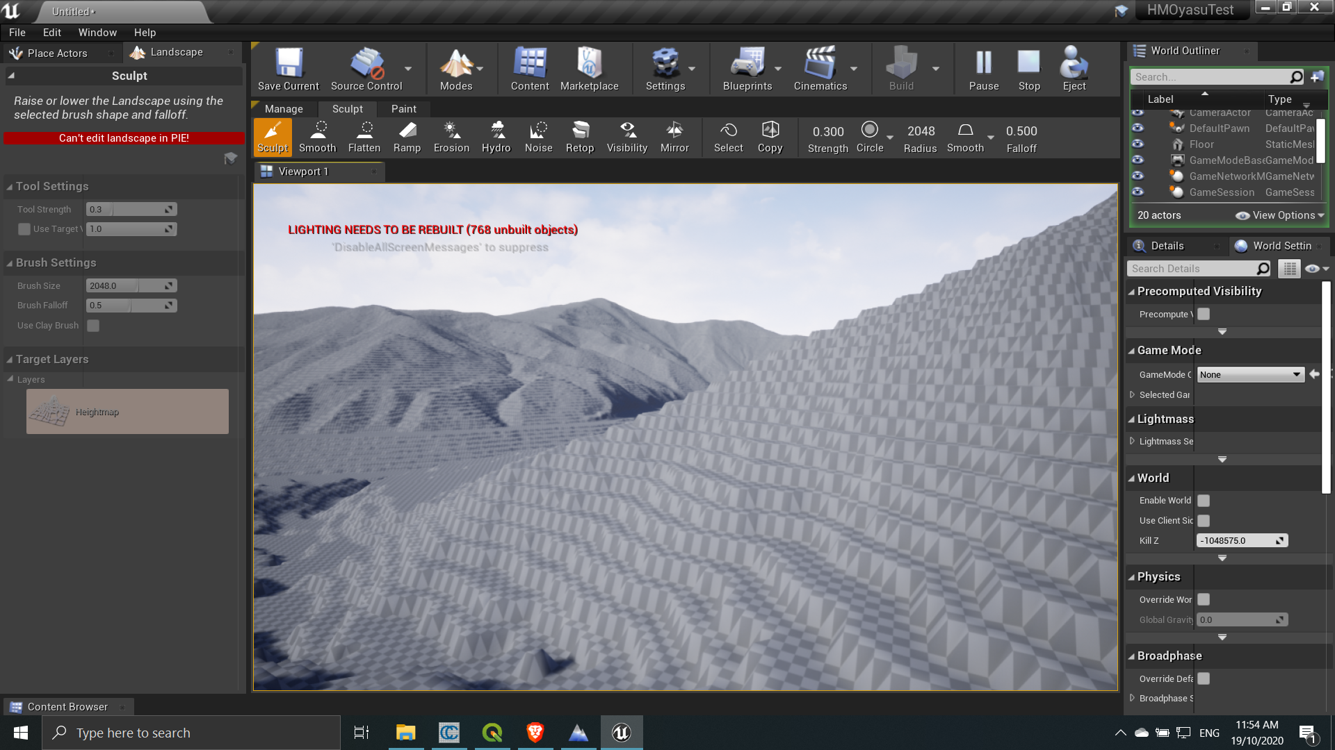

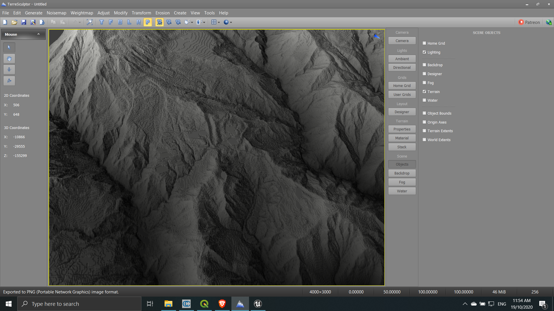

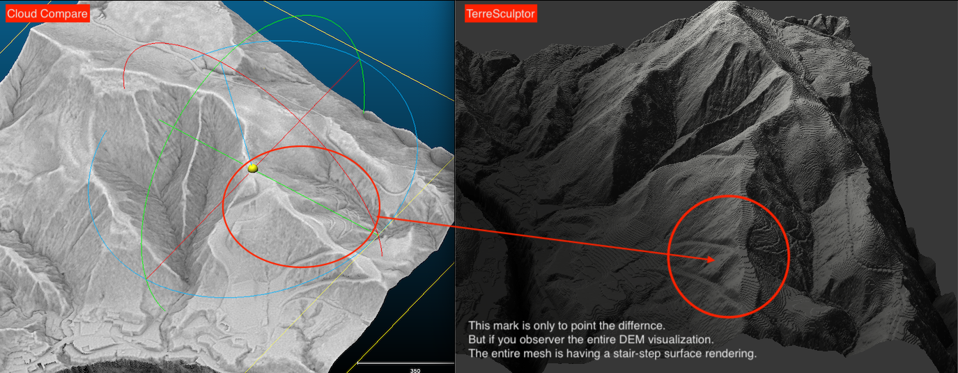

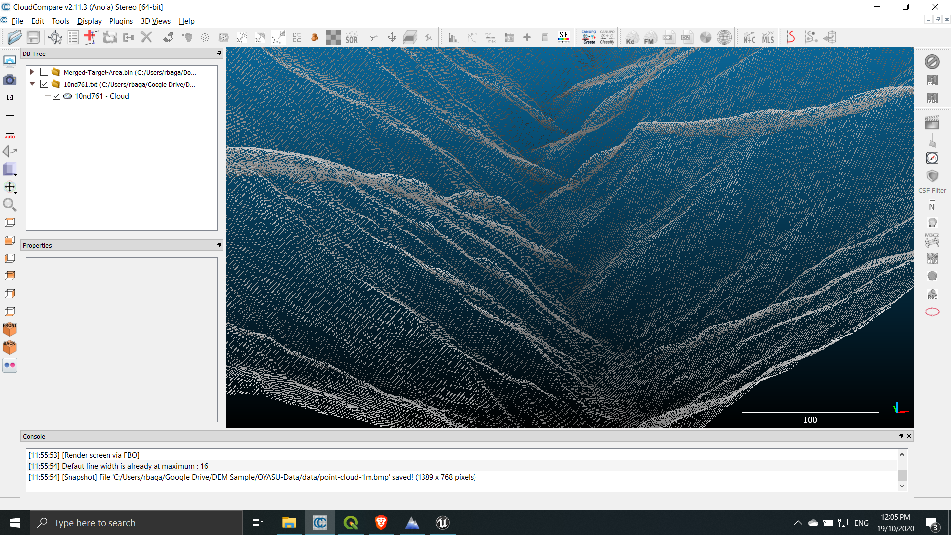

We took a 1m lidar resolution for a mountain, inside Cloud Compare, the visualization seems accurate but the rastered image doesnt seem to interpolate between points hence the terracing effect. Here's the screenshot from Cloud Compare to TerreScultor to Unreal Engine
