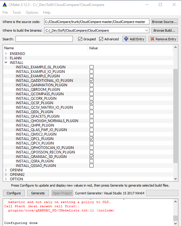

For the configure under "INSTALL", I checked QADDITIONAL_IO_PLUGIN, QCSF_PLUGIN, QPCL_PLUGIN and QRANSAC_SD_PLUGIN, the configuration gives no error, as illustrated below on left:
[img]C:\Users\SHAO\Desktop\CC CMake.PNG[/img]
Under Visual Studio, I have QPCL_IO_PUGIN,
But finally, neither in debug nor in release, I can't load a pcd file, with message as "[Load] Can't guess file format: unhandled file extension 'pcd'".

I believe the errors in CMake are only warning and should be ignored (CMake wouldn't create the project files if there were real errors).
