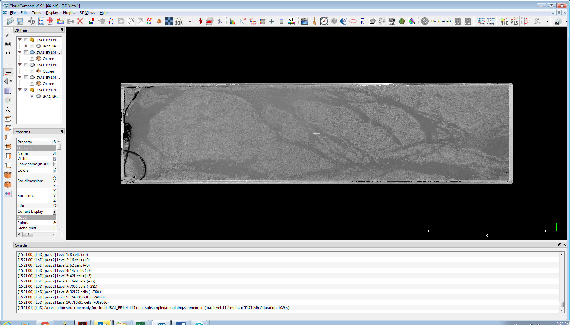

how can I remove vegetation from point clouds measured in a flume experiment with small alfalfa plants?
Re: At flume scale, how to remove vegetation (alfalfa)?
Can you show a screenshot of your cloud?
luz
Joined: Sat Mar 02, 2019 9:35 am
Post by luz »
luz
Post by luz »
sorry, i didnt see your replay until now.!
Is it a 3D point cloud? (i.e. you have points below the vegetation) or a 2.5D?
In the first case, you could try the Canupo plugin (https://www.cloudcompare.org/doc/wiki/i ... O_(plugin)).
Otherwise, it may work with CSF (https://www.cloudcompare.org/doc/wiki/i ... F_(plugin))
