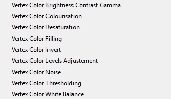

But you can do this in Meshlab. Under "Filters - Color Creation and Processing" you have various filters for brightness, contrast, white-balance etc.
