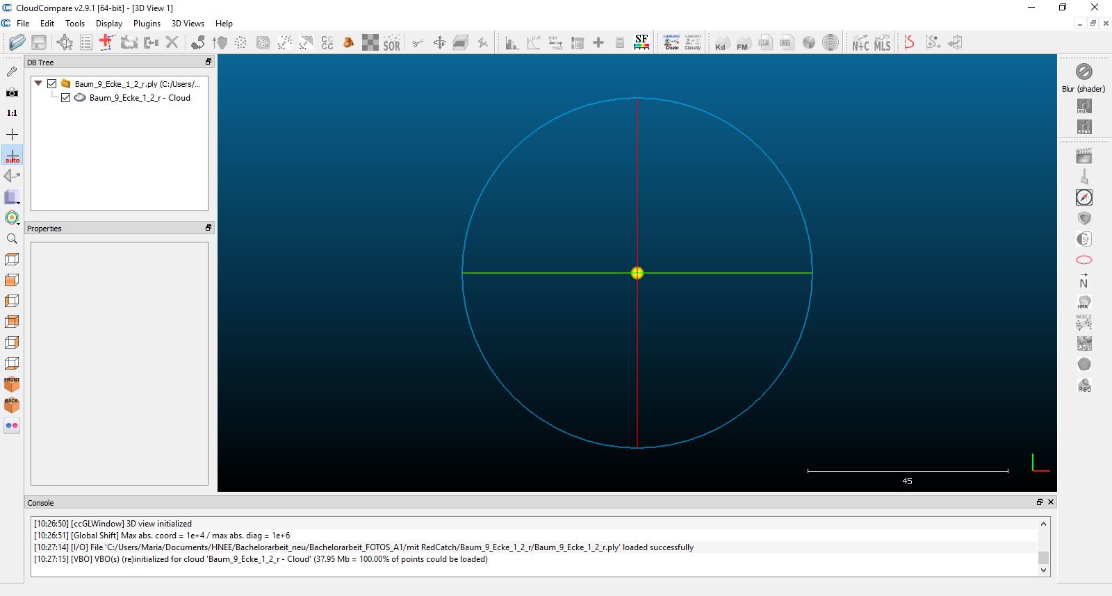

For my bachelor thesis I created pointclouds of trees to measure the diameter. For half of the point clouds I used a 3D ImageVector --Mono-- PPK camera attachment, which georeferences each photo with GNSS data.
My problem is, that I cannot open the georeferenced point clouds in cloud compare. The project is visible in the DB Tree section, but not in the main part. (picture attached)
Is there something I can do to make them visible?

It can happen if all the points are at the exact same position (it may be the case in the file, or it's maybe because there's a reading error).
Can you send me the file maybe? (admin [at] cloudcompare.org)

@msc818 Okay so your problem is that the points are in a strange coordinate system with XY having different units than the Z dimension.
When you load your point cloud, just rotate the camera (or look at the cloud bounding-box) and you'll see that it's elongated:
Either you find a way to export your points in a 'cartesian/homogenic' coordinate system, or you scale the points afterwards in CC (with the 'Edit > Scale / Multiply tool). But that's generally not a good idea when the differences in scale is that big (10^5!!!) as you'll lose a lot of accuracy.
