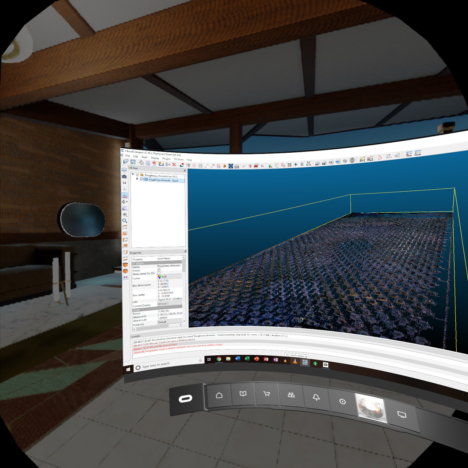

I am trying to use the Oculus Rift S with cloudcompare and having trouble viewing the pointcloud in the VR environment. I found this thread from 2016 with a similar issue but I'm not receiving the error they mention (http://cloudcompare.org/forum/viewtopic.php?t=1962). Same deal as in the post I linked, the Oculus software runs fine (Oculus App Version 1.38.0.250171), CloudCompare runs fine on its own (version 2.10.2 stereo). But I can't figure out how to initialize viewing the point cloud in 3D on the Oculus headset. All I can do is view the 2D desktop in the 3D Oculus environment (See attached screenshot). I'm running Windows 10 education version 1809 (OS Build 17763.529).
I don't care if the handsets work, I can use the mouse, I would just like to view the pointcloud in 3D on the headset. Does anyone know how to initialize this?
Thanks!
