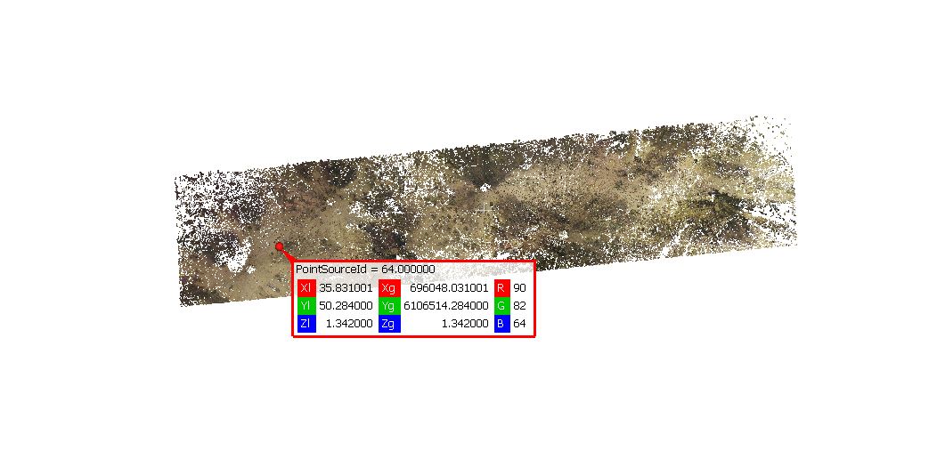

It doesn't look like that. Because, please look at the first attached image (prtscr1.jpeg), print screen from point cloud, it was taken by checking "Preserve global shift on save". As you can see it shows original (Xg, Yg, Zg) and local coordinates (XI, YI,ZI). If I export this file in PCD format, original coordinates disappear, but preserves local coordinates.

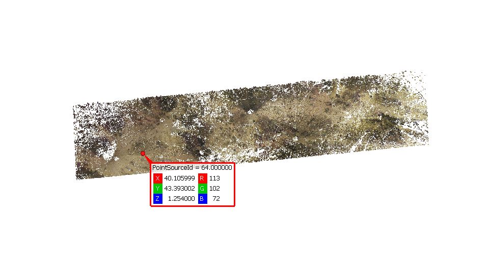

The second attached file (prtscr2.jpeg) is taken by unchecking "Preserve global shift on save". And it has no original coordinates but has local coordinates only. If I export it into PCD format, output file has only local coordinates.

- prtscr1.JPG (77.42 KiB) Viewed 19451 times
- prtscr2.JPG (75.14 KiB) Viewed 19451 times

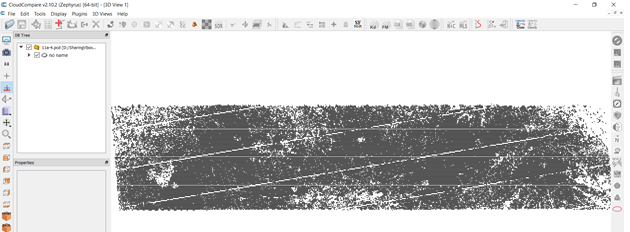

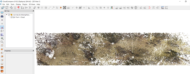

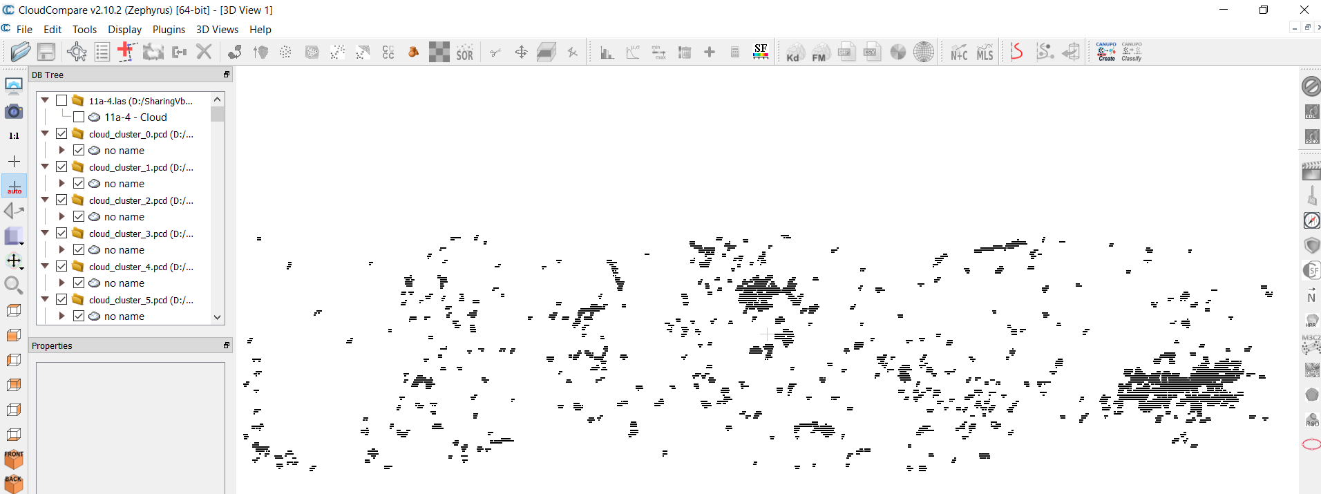

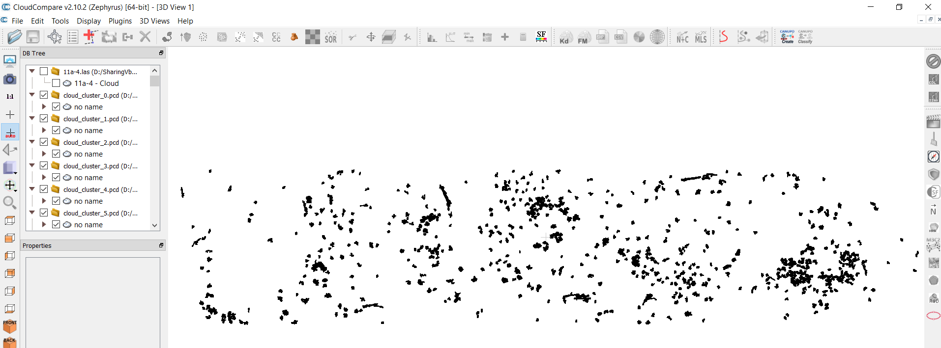

Sorry I am back to this question again. I need this LAS to PCD conversion in order to run PCL package. I tried to import LAS file with Global Shift "No" and it is converting into PCD by preserving coordinates. However, if I open PCD file in CC, point cloud turned into some strip lines, it doesn't look like LAS file one. Please have a look images below. And outputs from PCL package with Global shift and without Global shift are totally different. With Global Shift "No", PCL output is returning poor result (prscn4), Global Shift "Yes" is perfectly what I want for output (prscn3), but no coordinates preserved. Do you know how to avoid strip lines in point cloud when importing with Global Shift "No"? Thanks so much for your help.
Global shift "Yes" (prscn2.png)
and Global Shift "No" (prscn1.png)
