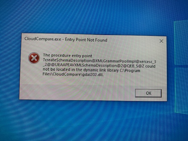

I recently attempted to install Version 2.10.2 with the FARO extensions and received an "Entry Point Not Found" error when trying to open the program. I uninstalled 2.10.2 and attempted to install 2.10.1 but with the same error. I then installed 2.9.1, again with the FARO extensions and this version of CloudCompare runs fine. I have attached a photo/image of the error message. Any help, advice, and/or thoughts on this error would be greatly appreciated. Thanks in advance for any input!

Hum, that's weird. Have you tried it with the 2.11.alpha version as well?
(it seems it uses the wrong version of the GDAL DLL...).

Same problem here.
Same with 2.11.alpha as well.
I noticed CC installed FARO LS 1.1.701.1
But the most recent version installed (probably by FARO Scene) is FARO LS 1.1.704.2
2.10 and 2.11.alpha WERE working. I'm not sure when they stopped. Maybe when I installed the newest FARO Scene update?
Not sure if that helps.
I'm in the same boat - only 2.9.1 works now.

I did a little more troubleshooting and now things seem to be working. I upgraded 2.9 to 2.10.2 but did not install the FARO extensions. Version 2.10.2 opened just fine and without error. I then reinstalled 2.10.2 with the FARO extensions and now everything seems to work fine without any errors.
