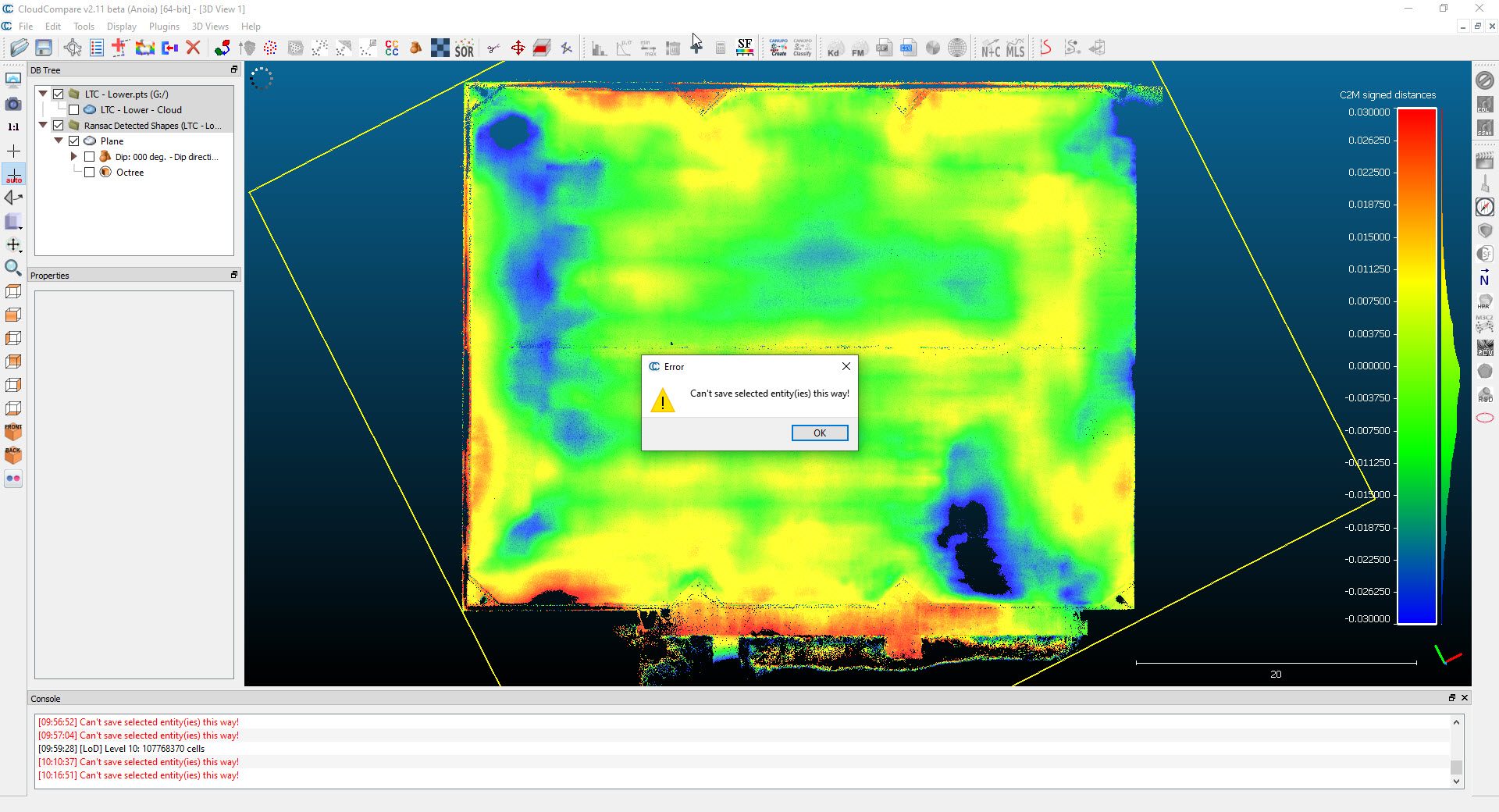

While trying to save my work. I get a "Can't save entities this way!" error. What am I doing wrong?

Warning, your selection is weird. You have selected two 'groups' (and a cloud inside one of the groups). What happens if you select only one cloud or one group?

Re: Saving Error
Post by Shaver702 »
Same error. :/

Re: Saving Error
Post by Shaver702 »
I just opened just to point cloud and tried to save it and i got the same error.
Re: Saving Error
Can you send me the cloud maybe? (admin [at] cloudcompare.org)
Is it the latest beta release?

Re: Saving Error
Post by WargodHernandez »
What file format are you trying to save this as, some don't support more than one object, or hierarchies (the folder structure), or meshes.

Re: Saving Error
Post by Shaver702 »
The PTS file is 26 Gbs. And my Box account won't allow me to upload it. Too large.
It starts as a PTS, are you saving it as that as well?

Re: Saving Error
Post by Shaver702 »
I just hit the save button and don't get any farther. I don't get the option to select any other format.
Re: Saving Error
And do we agree that you only highlight one cloud for this test? (like 'LTC - lower - Cloud' or 'Plane')
