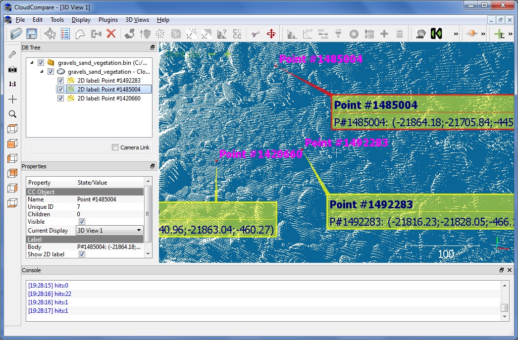

something here is wrong (i enabled "Show 2D label" as in your image)
i have view like below:
if i select anything on tree (shown on left screen side) it works - and border (red) is shown
but if i try click anyware on "3d view" (right side) - i could NOT select any point or label assigned to it.

Selecting 2d label works - if no mesh or points is behind it. (point 1 in upper image)
(2d label are so large - why should they be used?)
I want to "select" red square that is painted on "picked point" (not label)
Perfect solution would be selecting multipe points - with drawing rectangle with mouse (area)
if i move labels outside mesh/cloud point like in image below:
sellection works.
but again "2d labels" are too big for use. 3d labels or those little squares would be great.
is some kind of "mouse grabbing" implemented on CC?
sellection works.

I've modified the default point marker. It's now a sphere that the user can select in the 3D view. It goes from magenta to red if selected. So in your case you should hide the 2D part of the label and only work with the 3D version.
