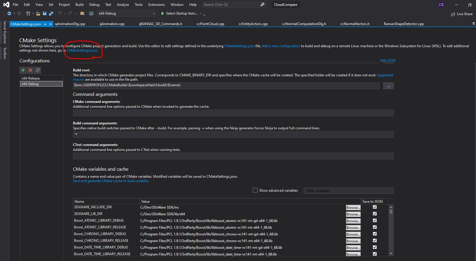

I would suggest using visual studio 2019 CMAKE, just right click on the folder C:/Users/bierlaire/Desktop/CloudCompare and select "Open with Visual Studio".
then set your CMAKE settings from the project menu

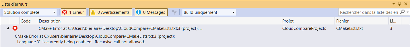

Now trying to right click and open the folder, I get this issue :
I have tried to look at CMakeLists.txt, but I have no clue on what should fix this error.
Do you have any idea ?

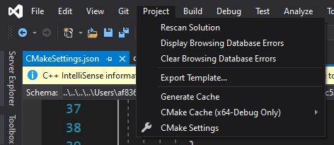

To give me a better idea of how you have it set up, please attach the CMakeSettings.json file that VS2019 created.
go to the CMake Settings like before and then select CMakeSettings.json

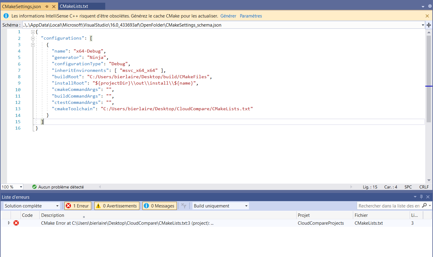

Here is my CMakeSettings.json :
  "configurations": [
      "name": "x64-Debug",
      "generator": "Ninja",
      "configurationType": "Debug",
      "inheritEnvironments": [ "msvc_x64_x64" ],
      "buildRoot": "C:/Users/bierlaire/Desktop/build/CMakeFiles",
      "installRoot": "${projectDir}\\out\\install\\${name}",
      "cmakeCommandArgs": "",
      "buildCommandArgs": "",
      "ctestCommandArgs": "",
      "cmakeToolchain": "C:/Users/bierlaire/Desktop/CloudCompare/CMakeLists.txt"
WargodHernandez
Posts: 187
Re: Issue with CMake
Post by WargodHernandez »
I would remove this line
The CloudCompare CMakeLists is not a tool chain.
