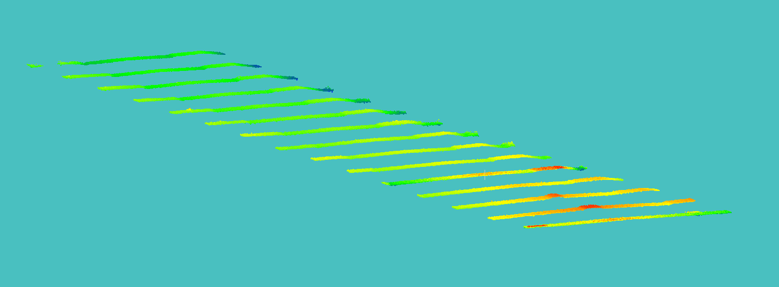

i am searching for an elegant way of a "local pointcloud analysis".
I attached some example screenshots and looking forward to read your suggestions.

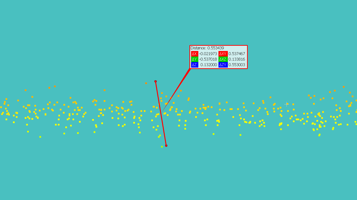

thickness (dZ) visible, but not local (watch dY)

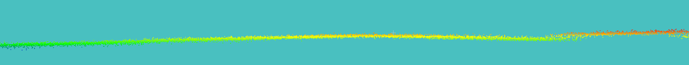

side view of single segment_far
road segments to analyse

You could try to compute the local "roughness" (https://www.cloudcompare.org/doc/wiki/i ... c_features)
Or use the Rasterize tool, and export the grid as a cloud with 'height std. dev.' and 'height range' in each cell:
