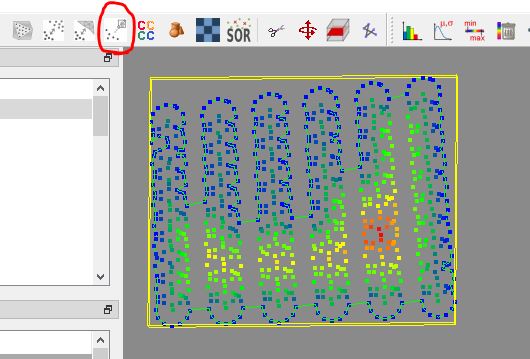

Have you tried the 'Tools > Fit > Facet' tool?
Part of the result should be the contour.

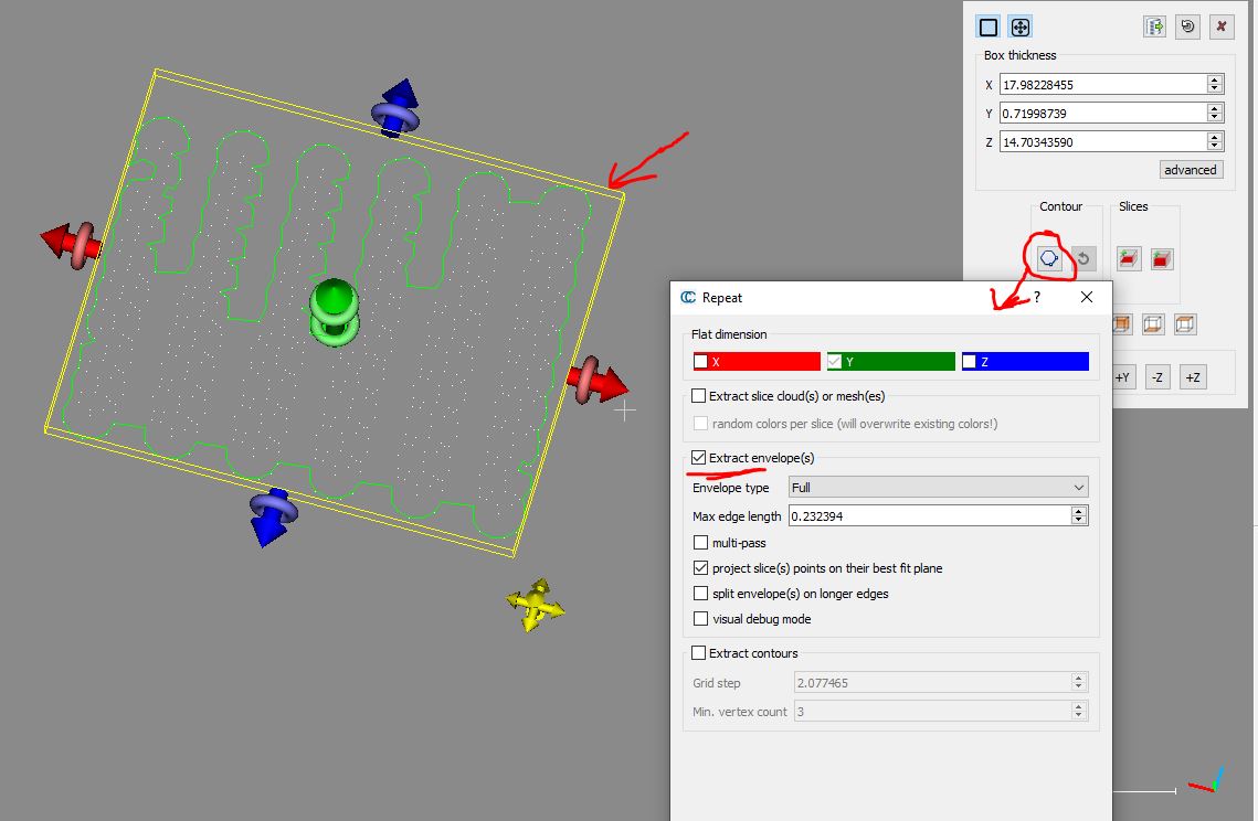

Oh, and of course, you can do nice contour extraction with the 'Cross section' tool (https://www.cloudcompare.org/doc/wiki/i ... le_contour)

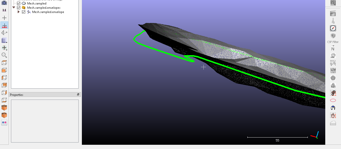

I tried every thing but no luck because perimeter points has different z level .
Fortunately , my cloud points are always dense (generated by mesh sample points) this why I think it is not default to find perimeter point with some algorithm

It should not matter if they are not on the same Z level, I think the confusion is terminology, in the cross section tool under extract contours, the thing you are asking for is called "Extract envelope" rather than extract contours.

This helps a little but Z values of polyline does not match Z of perimeter of mesh?
XY are OK
The goal of extracting of mesh perimeter is to build with minimum manual intervention more realistic cover for mesh instead of close hole function in Blender and FreeCAD etc
This cover is to be used as upper cloud points for volume (2.5Dvolume) calculation in CC and GIS etc

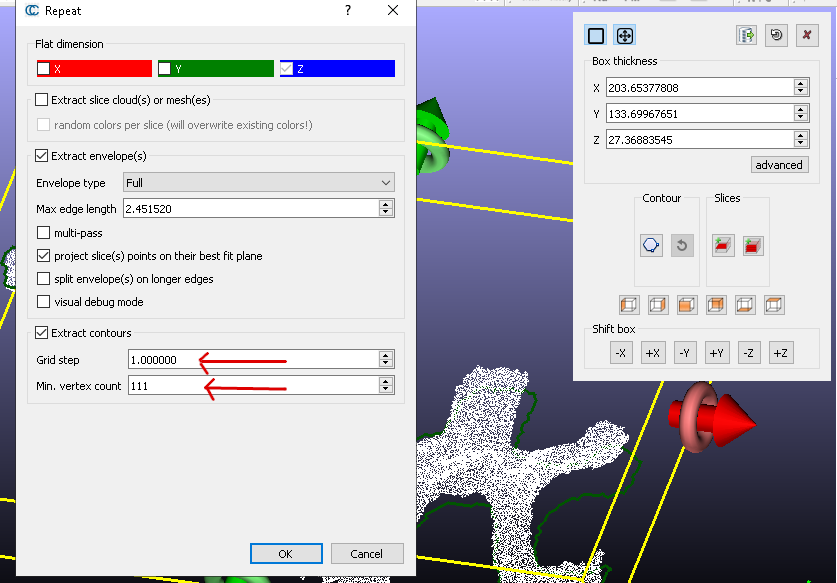

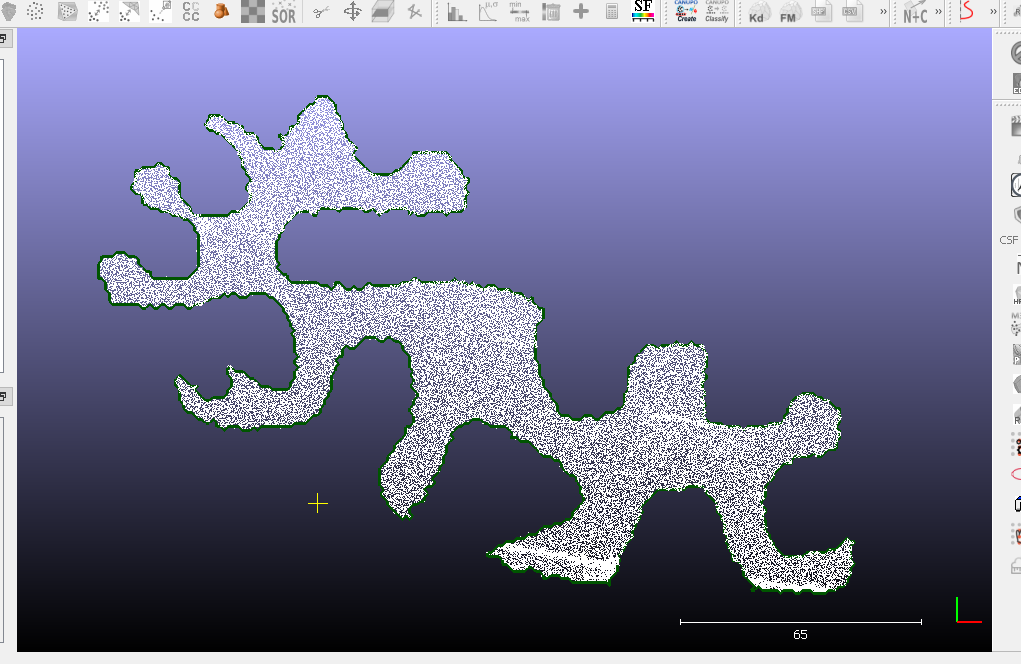

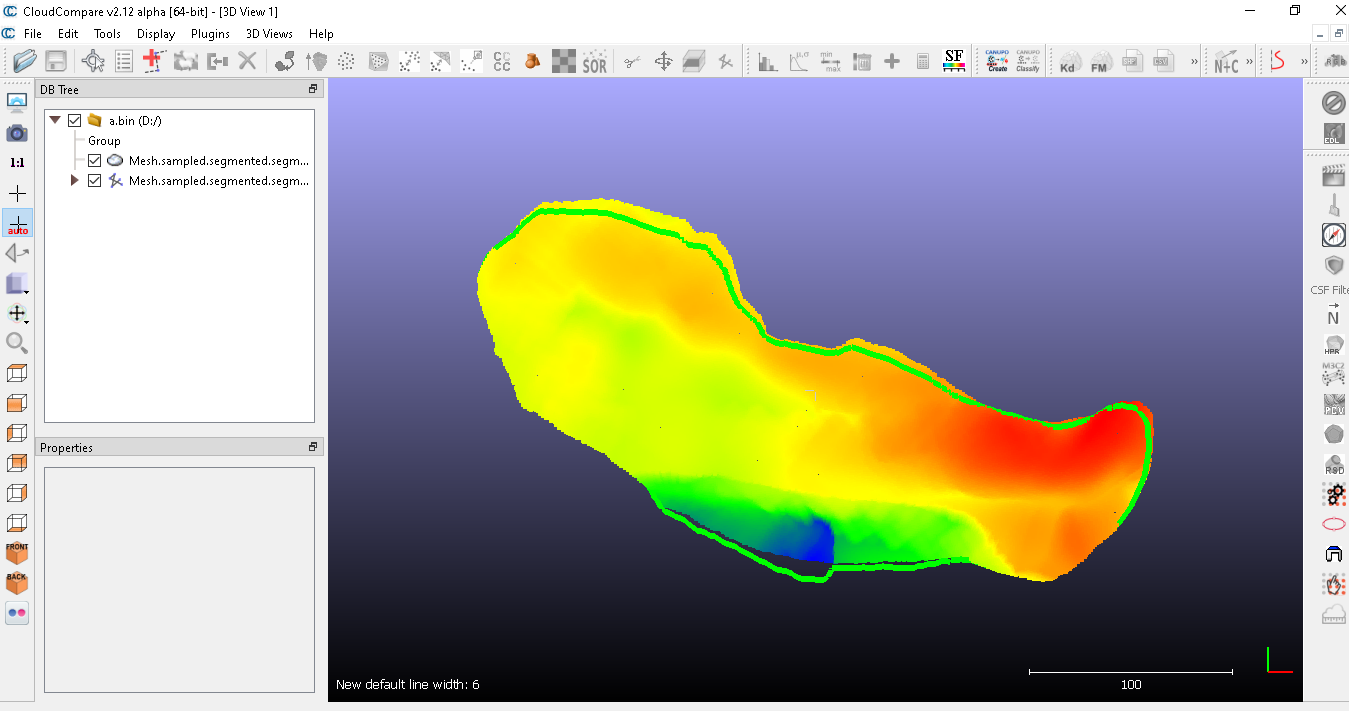

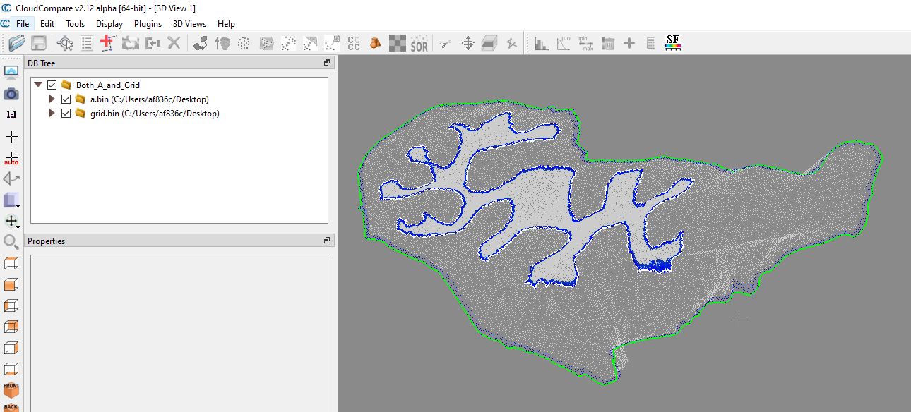

However, I found that polyline contour sometimes is not accurate in xy plane especially if there is big variation in mesh Z
see in image below
But playing with grid step & min. vertex count makes result polyline accurate in xy plane
a.zip
(447.55 KiB) Downloaded 2593 times
grid.zip
(1009.13 KiB) Downloaded 2698 times
