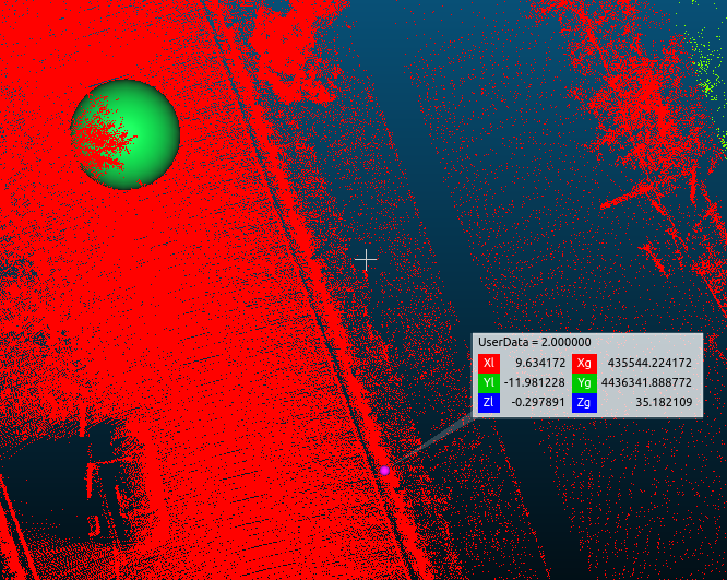

hello,
How to change the label color.
As shown in the picture, this dot shows magenta and I want to change it to another color such as yellow.
thanks

If you are referring to the point symbol (the sphere), then it's a global display parameter: https://github.com/CloudCompare/CloudCo ... ext.h#L107

I was surprised that your 'Y' label appears to be black instead of green. Have you changed that or is it a display bug?
Otherwise, I guess it would be easier to display (temporarily) some spheres where the points are if you want to achieve this result. You'll be able to control the diameter and color of each sphere.

'Y' tag that problem I do not know what happened reopen the cc once and it is fine.
If you load the sphere, the view is not as good as label, as shown in the picture
If you zoom in, the ball will become very large and block many points.
And label will not.

Then if you are in a plugin, you could probably create your own entity that looks a lot like a 2D label (but that only implements the sphere part) so that you can control the color, etc.
