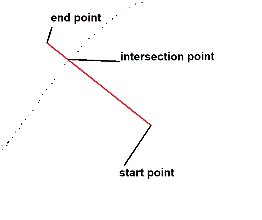

i dont know if i will be able to show in a picture, but I will try.
The input will be several lines, coming from dxf for example, and a point cloud.
The idea is to find the intersection as shows the attached picture

Re: intersection of lines and point clouds
Ah! Then maybe one option would be to sample points on the (poly)lines (Edit > Polyline > Sample points) and then compute the distances between the resulting cloud and the real point cloud. Hopefully the point with the smallest distance should be the closest to the real intersection point...
